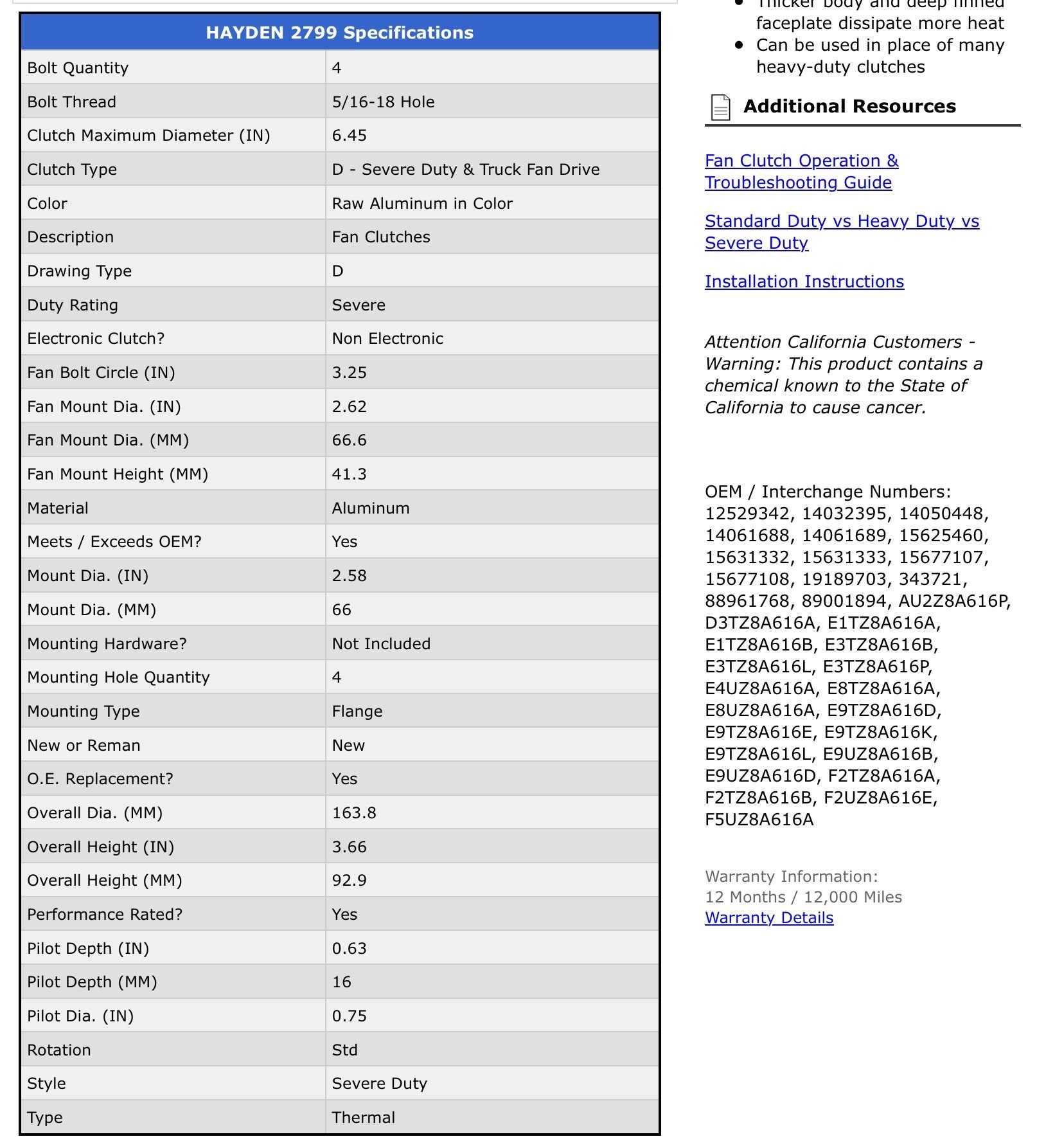

It has become very frustrating to locate a proper 1971 454 W/A clutch. Mine is toast and the one which was just delivered from a major corvette supplier was wrong. Checked the listing and it appears correct however mine is a 3/4” pilot and the one that is advertised is the small one with narrow bolt pattern.
most listings are void of these critical specs.

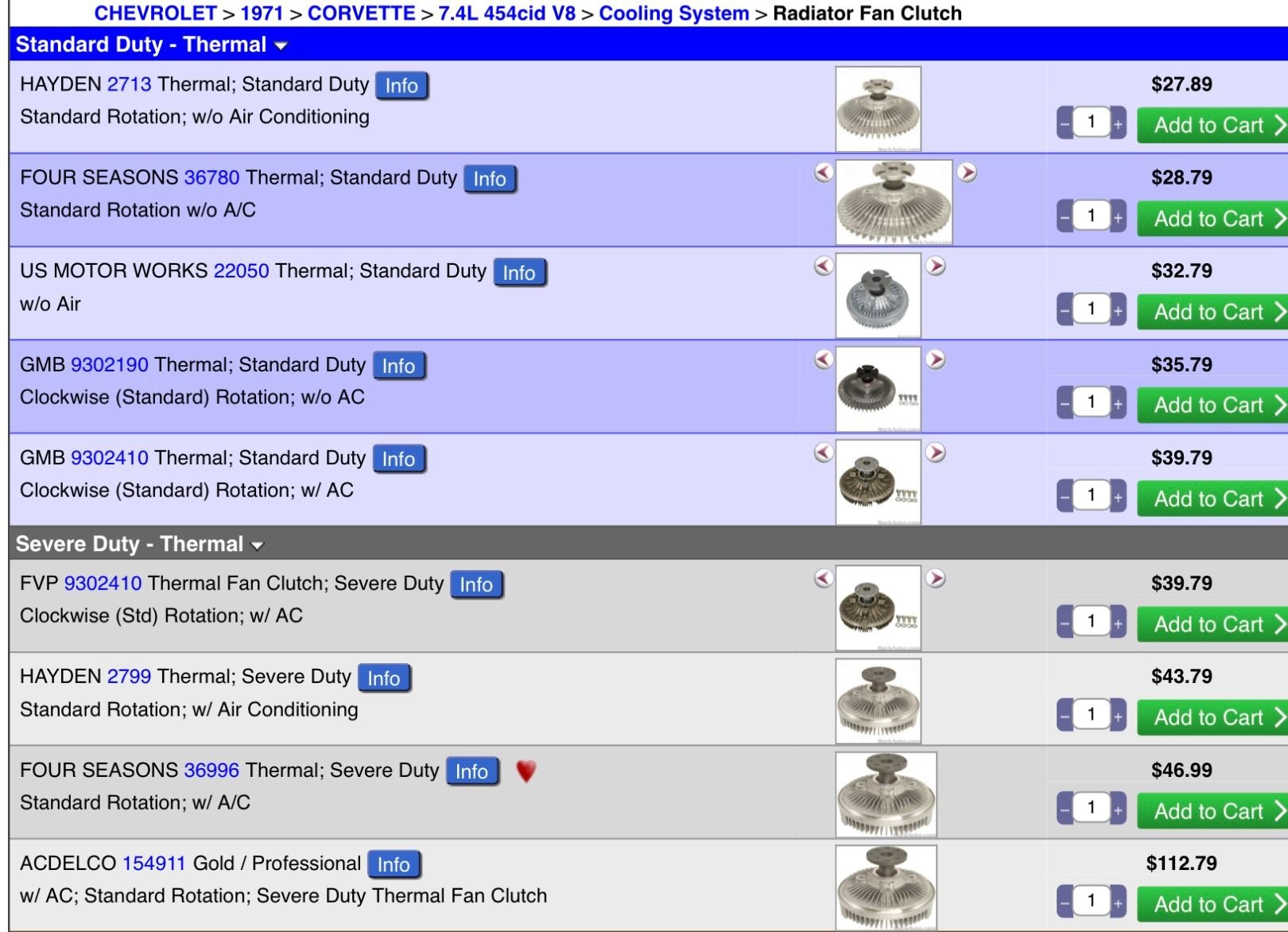

Hello Sqr. You might want to look at the RockAuto website. They list a few for your car and some do give the size pilot hole along with other specs. Good luck.

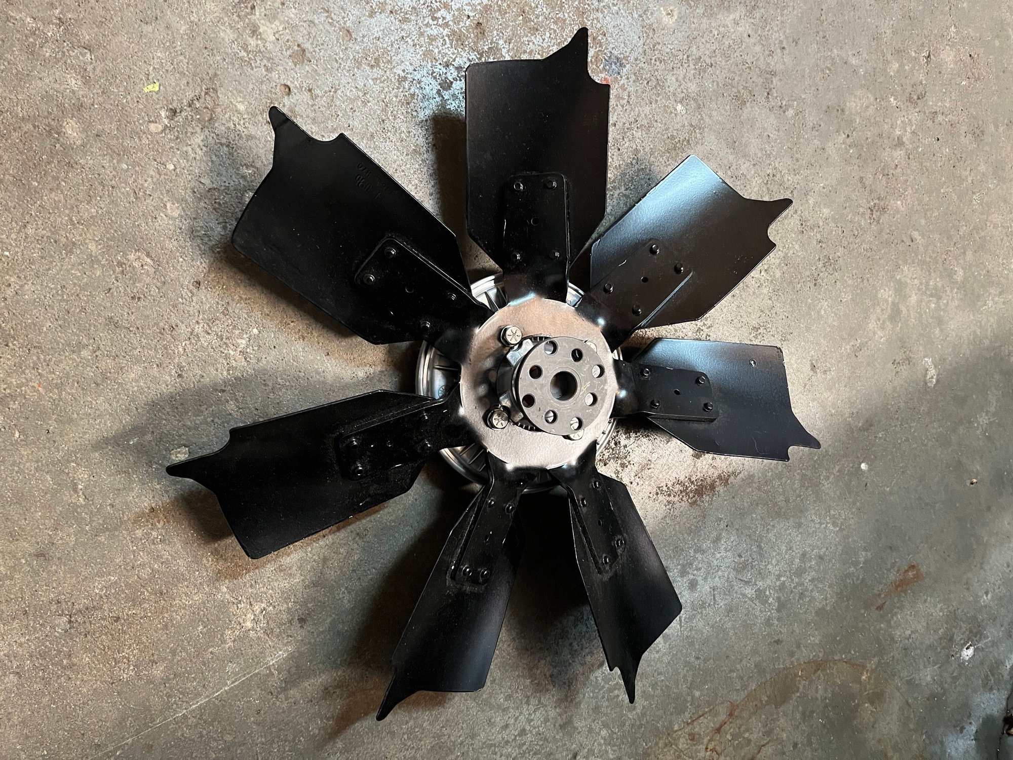

Thanks guys for the suggestions. On another note I am concerned about the shaft length which could affect the fan orientation with the shroud.
I have the original spike fan which has the fins very close the the rim of the shroud opening. The picture shows another aftermarket clutch which made the fan hit the shroud.

If there is a specific reason that you want a clutch fan (for originality, or whatever), good luck with your search. In addition to RockAuto, the ACDelco website is sometimes helpful for finding specific part numbers to cross-reference. Consider also that failing engine mounts can cause shroud misalignment.
Do you have a fabricated shroud on the top? Looks like it's too close to the fan.

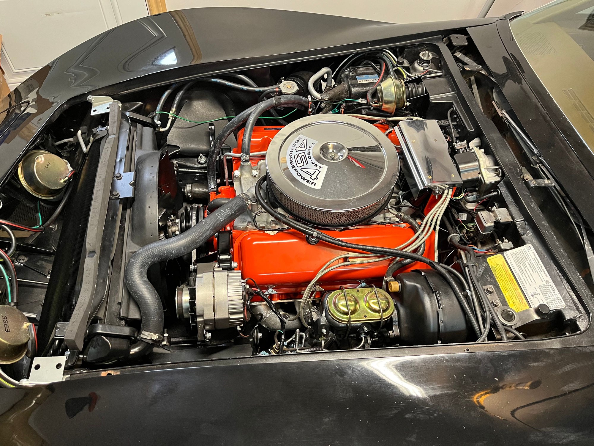

My original factory setup.

That was an old picture where the shroud was hit by the previous owner. I have a replacement OEM shroud but it remains close. I am going to remove the OEM motor mount shims to drop the engine down.

Original part number was 3991426
A 460742 72-73 may also work

thanks so much.
I am working on keeping it as original as possible.

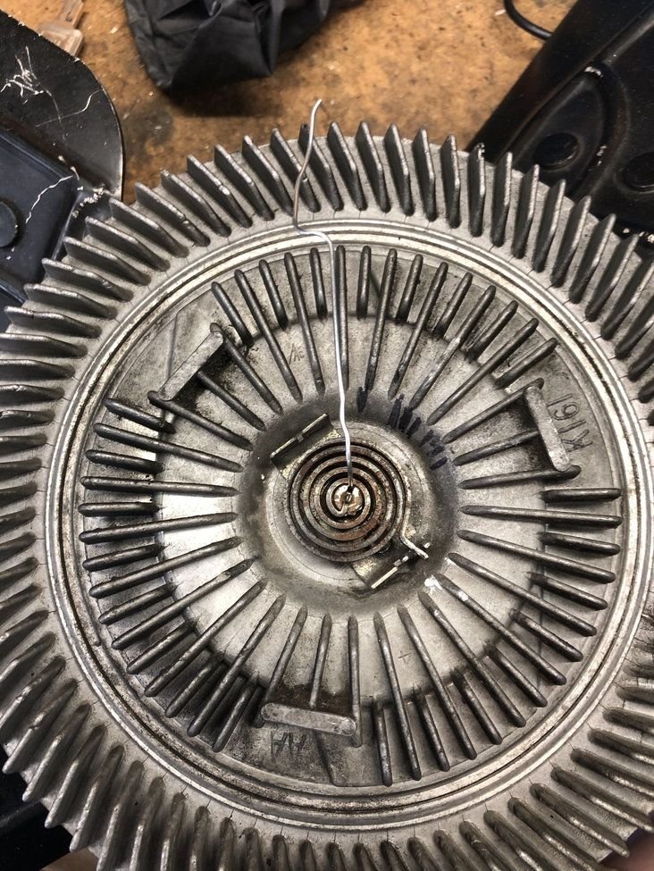

Just an FYI.. i was able to fix mine (see video) AND adjust the temp it comes on with lower thermostat..
thread here..and advice learnings. note mine once freed works perfect.. they do get stuck..still is working perfectly.. of course all the fluid gone another issue.. make sure the spring vanes are free
