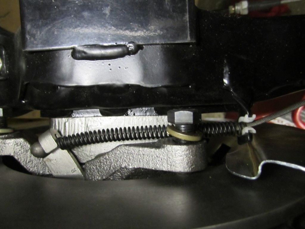

Originally Posted by C3 4ME
Ok, i took the cable out of the brackets and was able to get it to attach to the lever at the parking brake. Now, how do i get it back in the brackets? Also, i beleive the spring thats up against the lever should be behind the last little bracket that's behind the backing plate for the rotor, right?
Disconnect / loosen waaaaay off the cross cable from the front/back cable. Yes the small spring should be between the lever and the little bracket, there should be a small plastic clip/guide, white in this picture.
Make sure the cable is free to move in the outer sleeve or that little spring won't push the brakes off

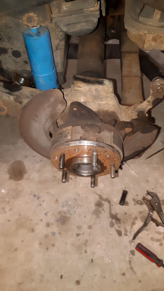

Surpisingly, with just the drivers side working, it would hold the car on a slight incline. That was with the handle pulled about 3/4 of the way up.
Here's the current state of the driver's side, to add to the discussion. And, it just occured to me that as you can see, the spindle has been replaced (before i bought the car in '05) and i bet they did the parking brake on that axle then, which would explain why that side is all there and functioning and not the passenger side.
