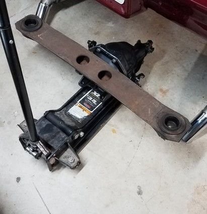

Figured you might think I am over the top, I'm just tired of the expensive, lousy work out there today. So, here is the painted posi I spoke about above for those who think I might have exaggerated.
