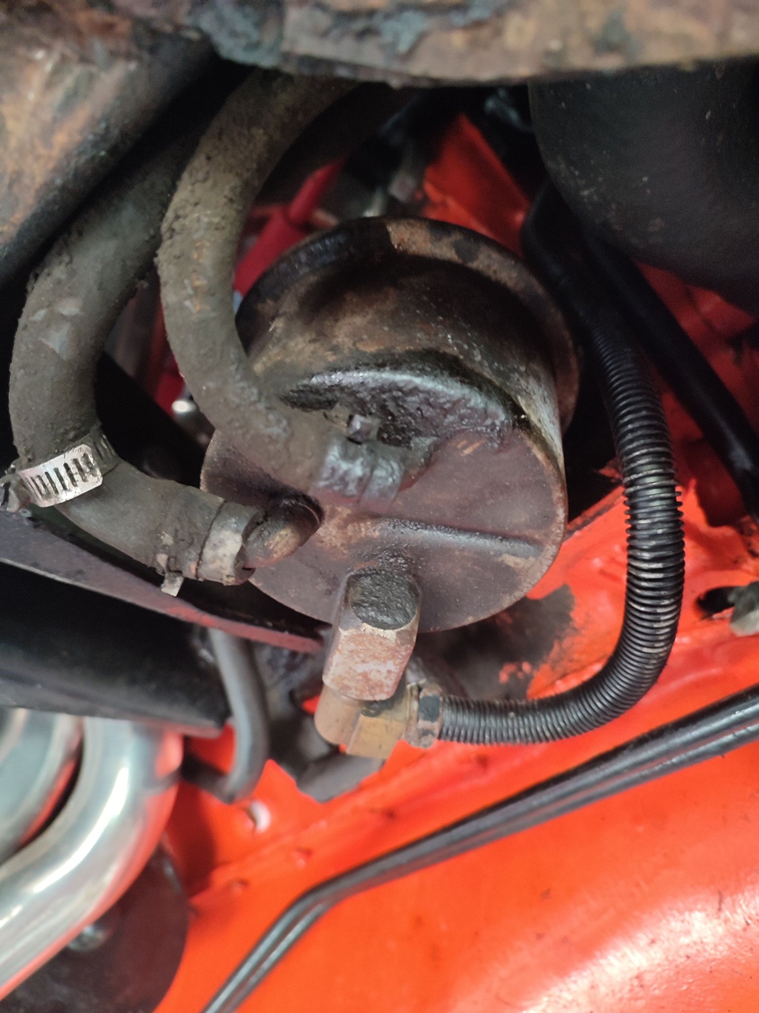

My work on the front suspension is still not done, so the front of the car is still in the air and I have lots of space.
Should I replace the fuel pump? (It seems original.) Or should I leave it alone?

Looks like one of the fuel lines is ready to start a fire.
And one hose clamp is just sleeping there.
I would toss all three clamps and look on European EBay for stainless clamps that do not damage the rubber. Usually found associated with fuel injection parts.
They are a little more money but a much better design.
