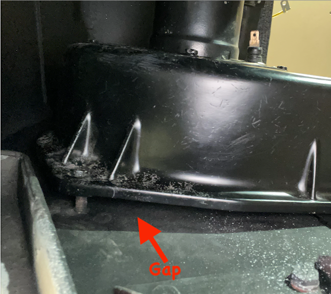

Hi
When I reassembled the heater-box and fan assembly I noticed that there is a big gap/space between the fan assembly and the firewall.
At the moment it's just a first test mount of the fan-assembly, and the butyl-tape is not yet added.
My question is if som one has this expertise ?
Is something wrong?
Or shall I just add a thicker gasket, together with the butyl-tape? And just force it to the firewall with the nuts.
And while we're on the topic, what is the square hole used for?
(Facts:
The body is hanging free and is not mounted to the chasi.
I didn't disassemble this car, I got all parts in cardboard boxes.

Square hole is for mounting the heater hose retainers.

That blower housing should sit flush it looks like the bolt is holding it up.

it’s not, the bolt is going through and fits in the hole, I can press the fan housing towards the firewall and fit a nut on the bolt.

Thank you, I just wanted you to know how helpful that was 🙏

If you force the housing down tight, make sure the fan isn’t hitting inside. I don’t think there is much clearance in there. Loosen or remove the fan from the housing and see if it goes down flush without forcing it.
