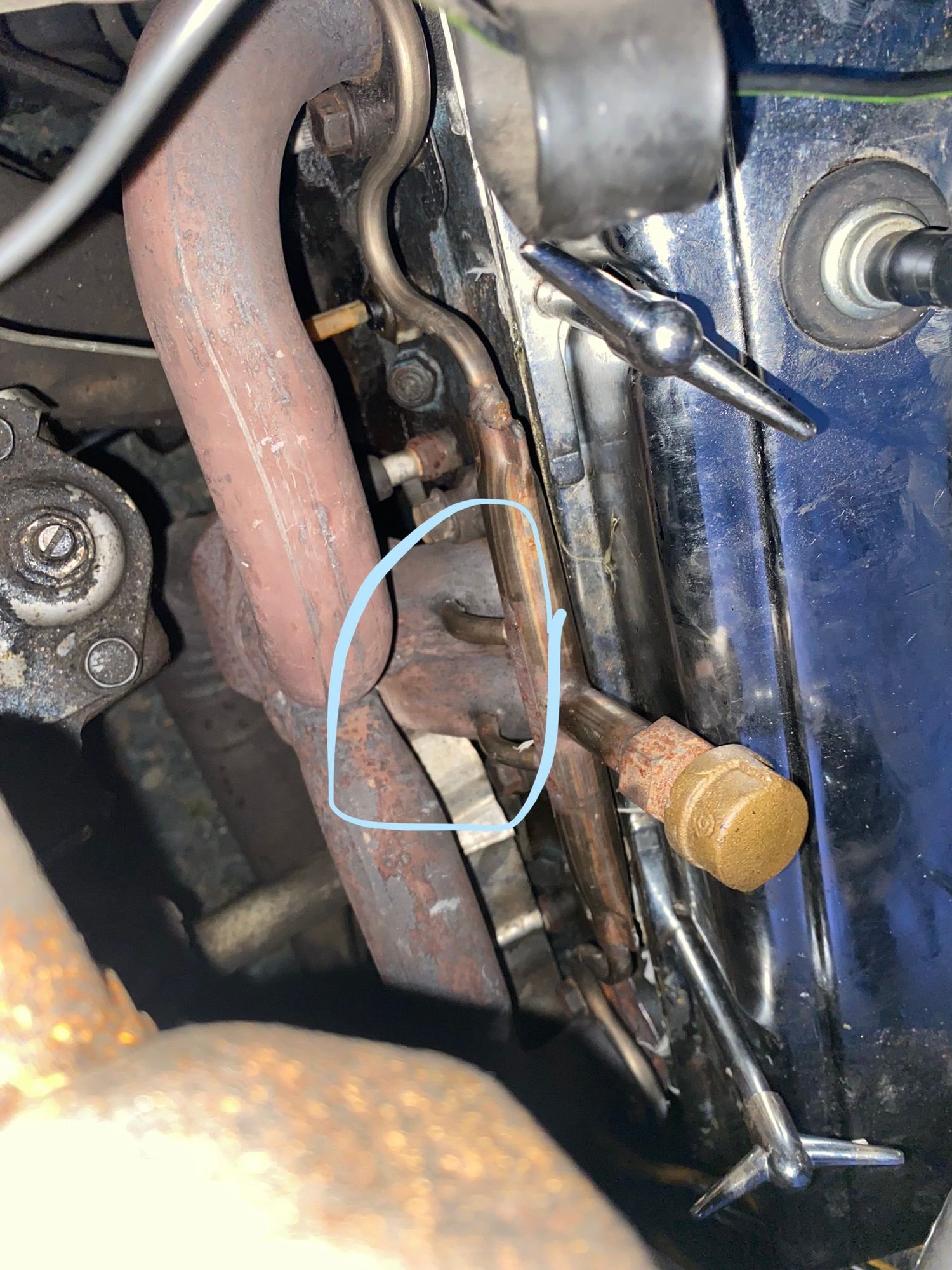

I believe it’s coming from right here where the AIR piping is welded to the manifold, this is where I’m wondering if I can weld it

That AIR tubing is for the injection of clean air into the exhaust ports supposedly to aid in complete combustion (think cleaner tailpipe emissions) . The AIR pump was driven by the fan belt system, most likely your 81 has had all the pollution crap removed, and I see your AIR port is capped.
Dont go on my word but think I remember reading those headders are SS as well as the AIR tubing and if so welding shouldnt be a problem.

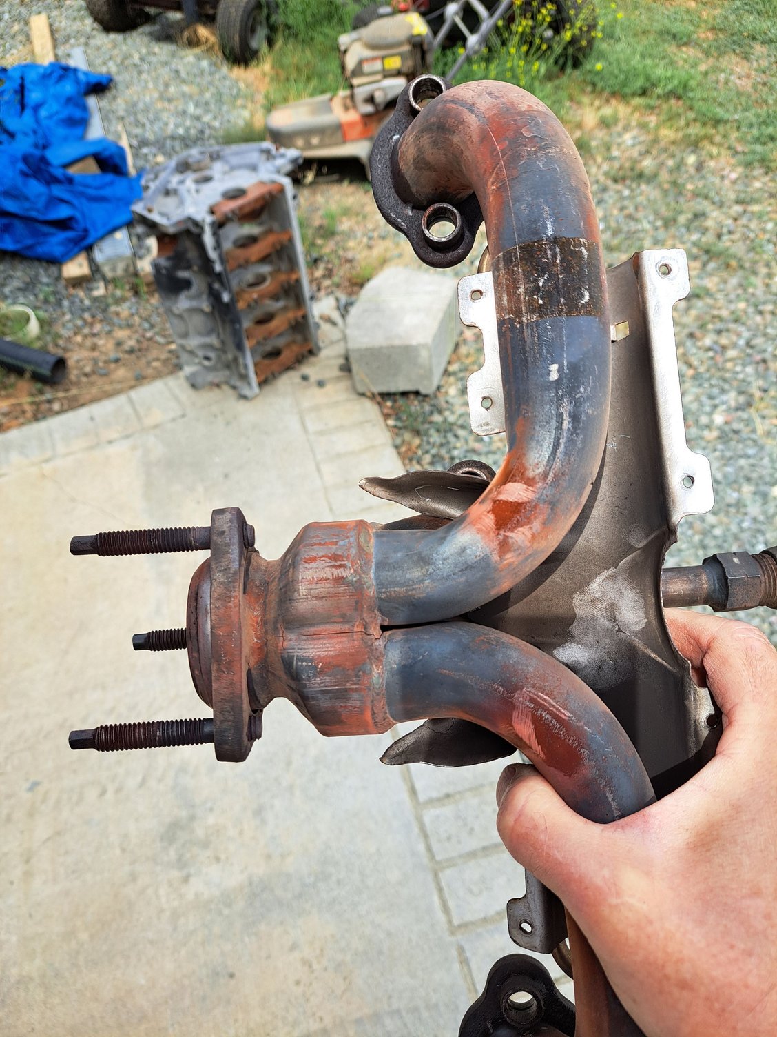

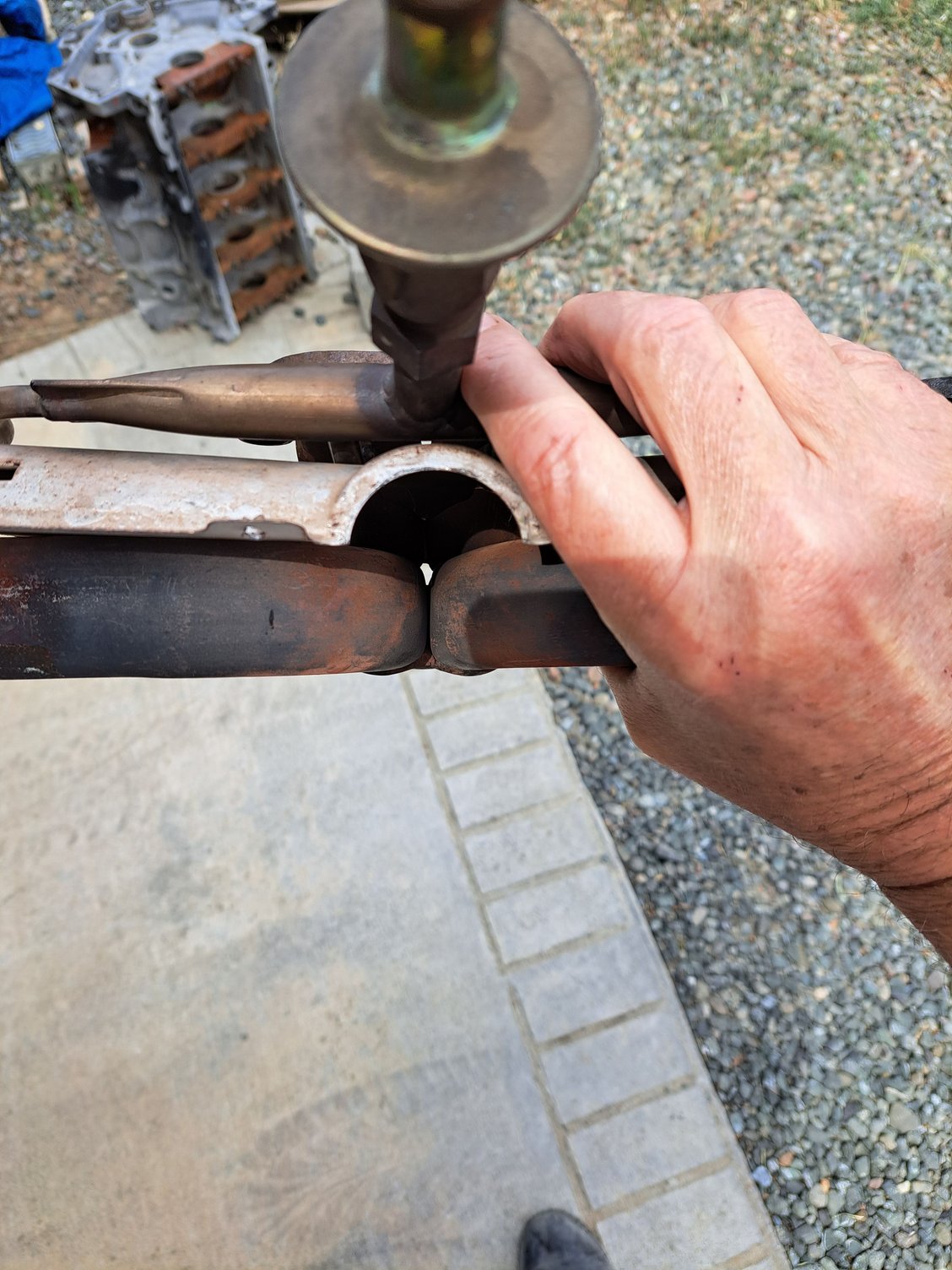

Car came into my shop w/ fairly loud exhaust leak on drivers side.... remove the exhaust manifold & found this: Doesn't appear to have been completely welded from the factory... plus a small crack as well...

that thing you're holding is a factory header, with the A.I.R. tubing attached. (AIR is air injection from the air pump driven by a fan belt- used to inject air into the exhaust in an effort to support complete combustion)
Bring that piece to a weld shop and have it welded up, a good welder can do that in 10 minutes.Its stainless steel and can be welded. Cheaper than any other fix.
