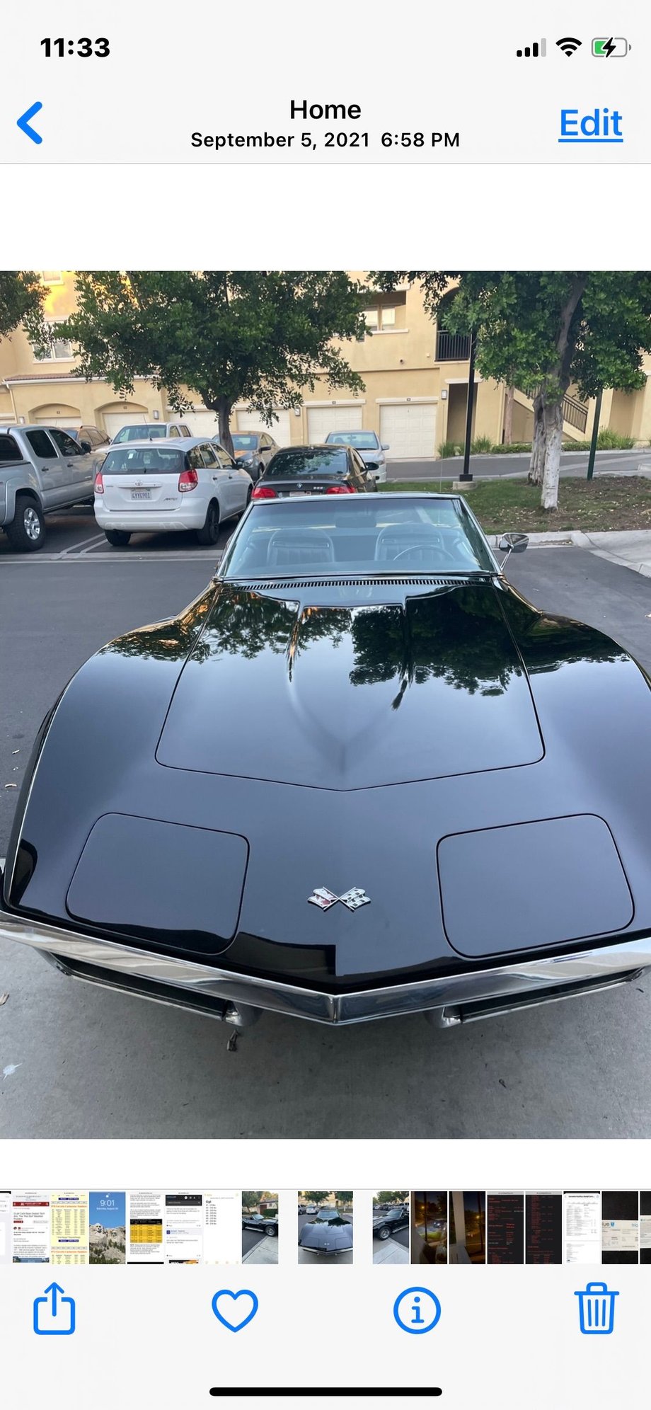

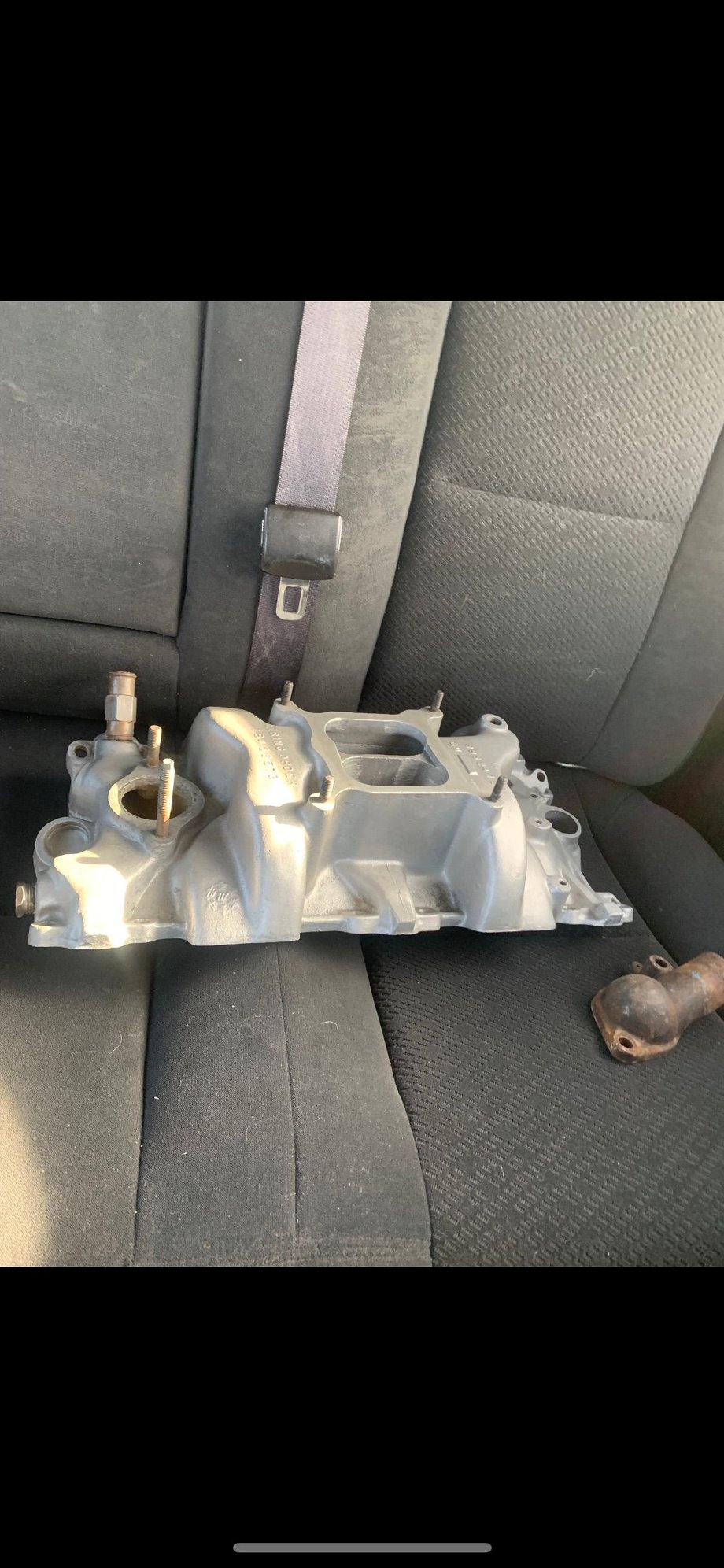

Default 1970 LT1 Hood
This is the intake
My hood currently
My stock 350 without the intake.
So you think that intake fits under stock hood ? Well I can always put it on and set the carb and air cleaner and close it right? I just thought it wouldn’t fit because only a edelbrock performer w Qjet fits anything else go to LT1 hood.

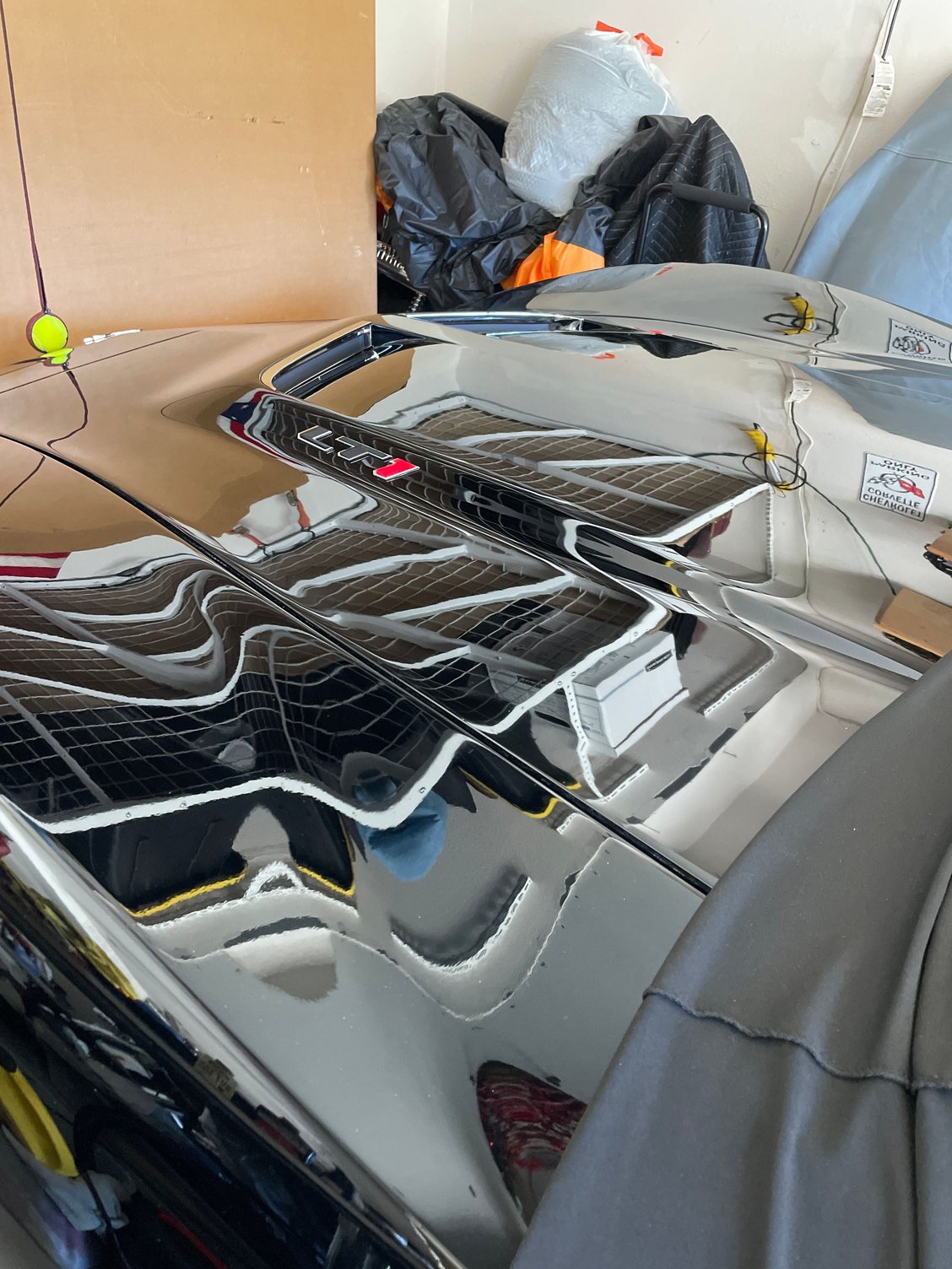

Default Winters intake LT1 hood. My LT1 Clone
Originally Posted by samaiello
I have a question, my 70 has a stock hood 350/300hp. I have a 70 GM stock winters high rise aluminum intake I believe was available for Corvette or Z28 Camaro I obtained and wanted to make sure if I go to a LT1 hood it will clear and close. I like the look rather than stock. So any comments is appreciated.
Yes! The winters high rise will fit the LT1 hood on a 350 sb BUT no quad no double pumper, I put a 750 VS and ordered the correct drop base for an LT1 air cleaner and used a 3” air filter. Had to add two sims in the hood to level looks awesome .
