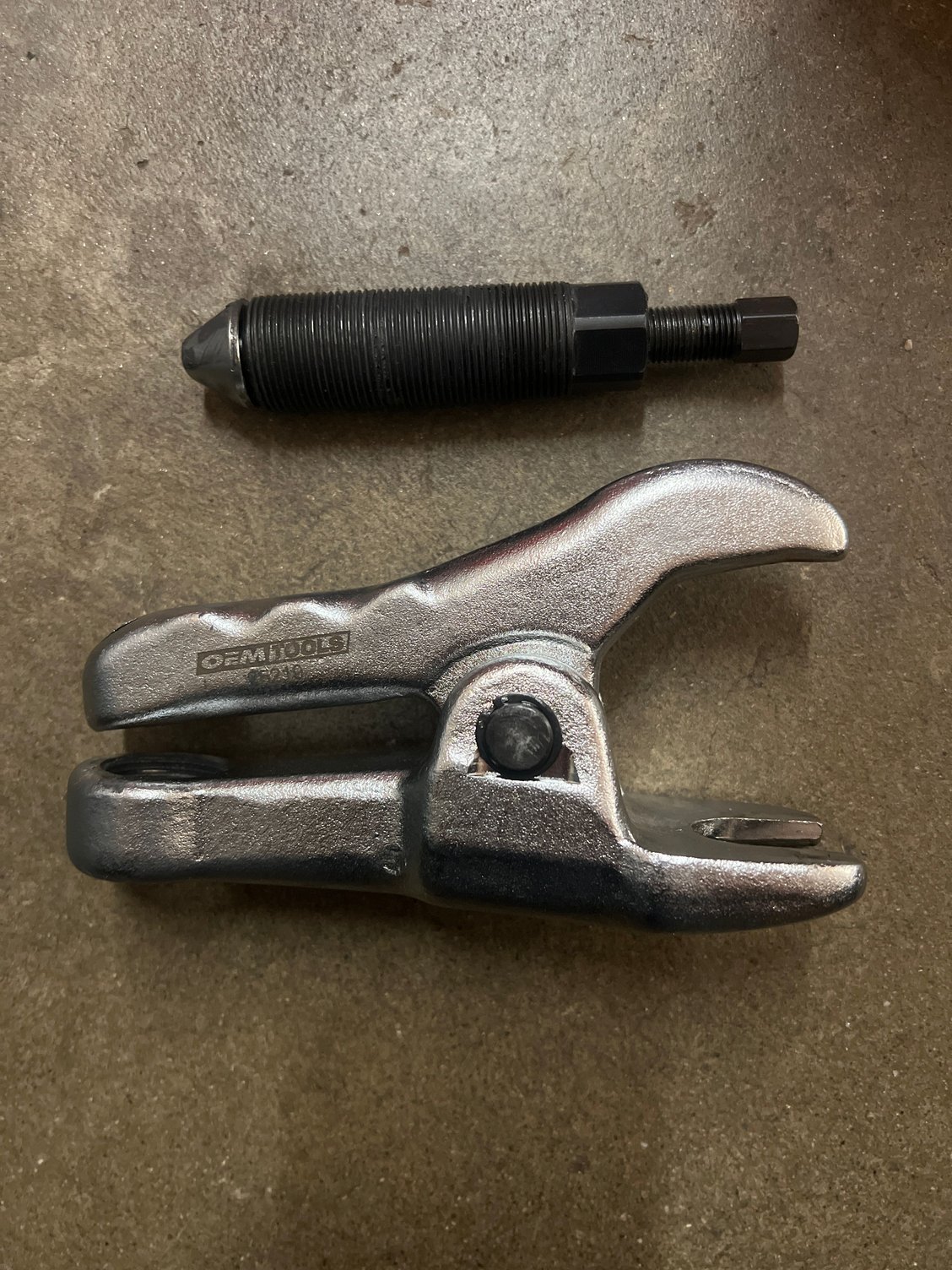

The Harbor Freight seperator is weak. If you don't have the clearance for that Mac tool, the best one I've used is this hydraulic OEM. You spin the bottom to preload it, then turn the small bolt on top--that is the oil filled part. 8 tons of pressure it advertises.
I think it was $85 on Amazon or thereabouts.
