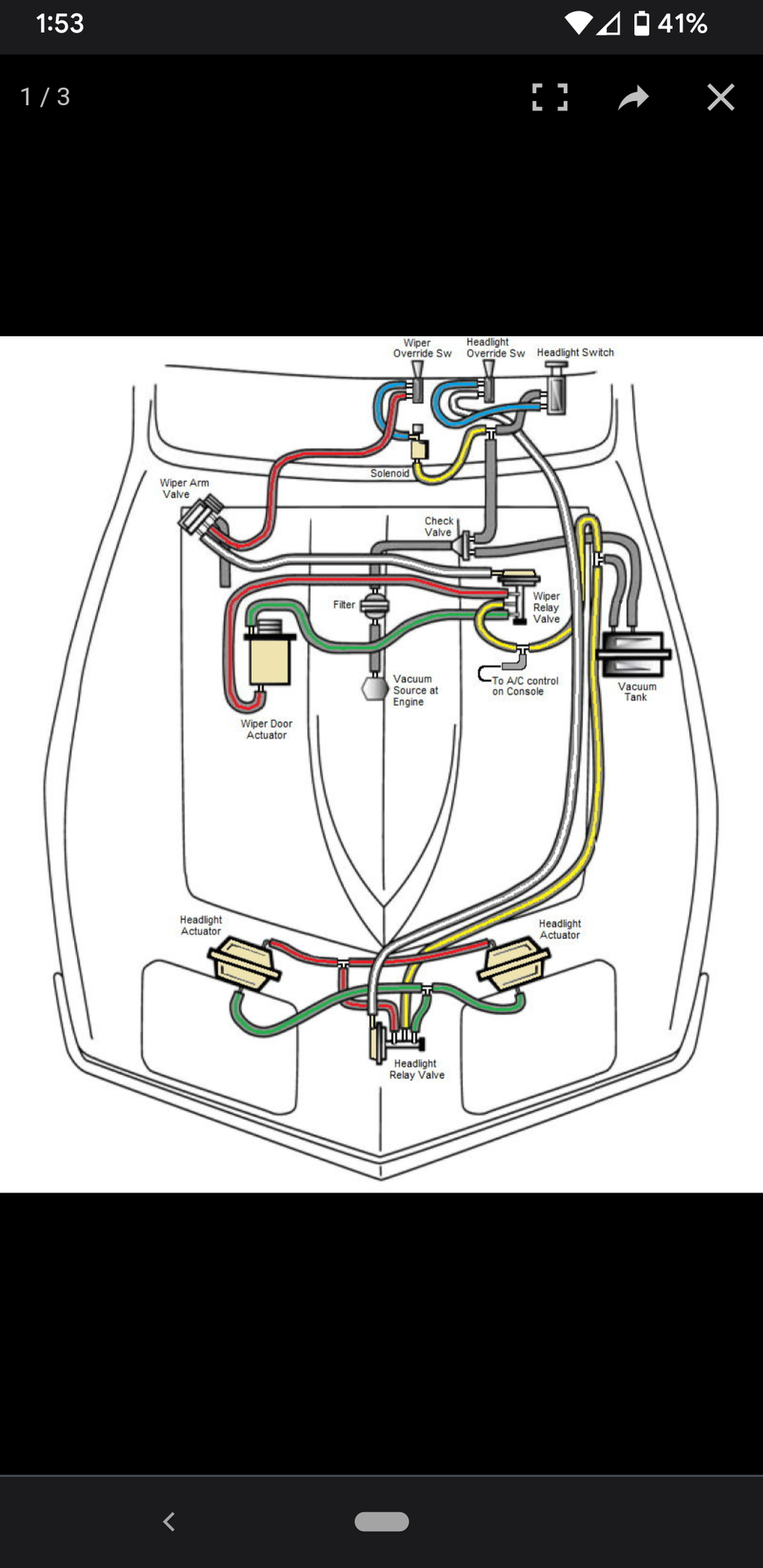

What is the effect if you do not run a vacuum tank? My 68's is missing and not loving the options of used or using the later model coffee can look.

the vacuum reservoir is used to maintain vacuum level. Is it necessary to have one, no but if you want a full working system, yes. You could convert your wipers and headlights to electric however

The problem also is when the engine is under load vacuum drops, the tank is there to stabilize vacuum. For example If you have no tank and your windshield wipers are on they will work poorly and let's say you floor it or start climbing a grade your wipers will loose vacuum, which means they won't work.

I'm no expert, maybe I'm not completely right but just to clarify the wiper arm valve and the wiper door actuator are tied in to the vacuum system.

Thanks all, you shared the answer that makes sense in that it holds vacuum when the car is off. Since driving will be limited, having to start the car to get the headlights will do OK for the moment. I was hoping I could get them functional with the hose/actuator rebuild kit from Zip and hold off on the tank for now. Will be an eventual addition, but other priorities will come first. This is a super helpful forum, thank you!

No one has brought this up. But has been brought up many times in past threads.
with no vacuum canister. When you floor it and your vacuum drops to near zero. Your headlight relays will switch to the spring operated possition. Meaning that your headlights will pop up. And then go back down when vacuum resumes.
Many, many people on here over the years complaining about headlights that pop up when they floor it. Caused by a lack of vacuum to the headlight relay valves that control the headlight actuators.
no vacuum canister = headlight doors opening when you don't want them to.

Its actually opposite of how you think it would be... in short with the throttle blades closed the engine just below the carb is trying harder to pull air past them so the engine sees more vacuum. with the throttle blades wide open the air is easily pulled in so just below the carb sees little vacuum....heres a thread I found if you want a detailed description
https://www.stovebolt.com/ubbthreads...at%27s%20there.
In short your headlights would be winking as you drive the car, if you drive like I do.....full throttle, let off, coast, full throttle, let off, coast, stop, pull out of 50 foot driveway onto main road, full throttle, coast, pass the cop that is always waiting for me, full throttle, coast....etc...

your way off, the wiper door operates with the vacuum system, wipers work with 12 volts, fail safe for wiper door is open, so wipers will work with no vacuum

Forum member Richard454 produces and sells kits to convert from vacuum actuators to electric headlight actuators and electric wiper door actuators.
No need for vacuum.
Richard’s Kits are top quality, he supplies excellent customer service, his kits are widely used by forum members and they are reasonably priced.
You didn’t supply any information about your 68, like, if it’s a big or small block engine or if the engine is stock or hi performance, or if you are running power brakes.
The reason I bring this up is, depending on your engine build and the camshaft grind it will effect the vacuum the engine pulls at lower rpm speeds.
On my 73, I’ve converted from the oem heating, ventilation and ac to a Vintage Air system which converts all the vacuum actuated controls to electric and I’ve deleted the windshield washers from my build as well.
The 73 has no wiper door and the wipers are electric.
I also converted from a TH400 automatic to a 5 speed manual, so no vacuum to the transmission module.
The only thing on my 73 which will run off engine vacuum will be my power brake booster and the distributor vacuum advance.
My point is, there are many things that run off vacuum in our cars, every model year can be different, so make sure your engine pulls enough vacuum to get you safely down the road while keeping your car running properly.
If you are simply removing the vacuum canister because it is unsightly, there are several aftermarket vacuum canisters that are brushed or polished aluminum or power coated, that look really nice.
