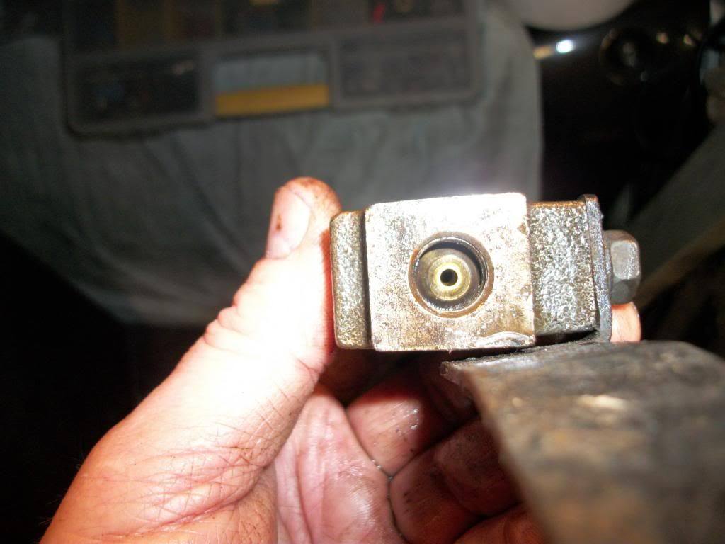

First off.....the early C3 Corvettes were equipped with what the OP shows.....which is really a distribution block with the brake sensor switch. Later model C3 Corvettes, these block were modified and did have a "proportioning" function by a block added to the back, and they also provided the switch function. But....whatever you call it....the OP was not asking for definitions.
My experience with these original blocks are that it depends on the condition of the conical seats in the brass threaded recesses. If they are nicked by the original installation of tubing into this block, you may have a problem with a new set of tubing that may not interface well with these previous nicks. So....it depends on that. Also of course the threads need to be in good condition. There really is not way to dress out any nicks down in the cavities. Also...you would want to buy reseal kits for that switch function....as there are o-rings in there that probably are original and dryed out. Someone sells those reseal kits for that valve.

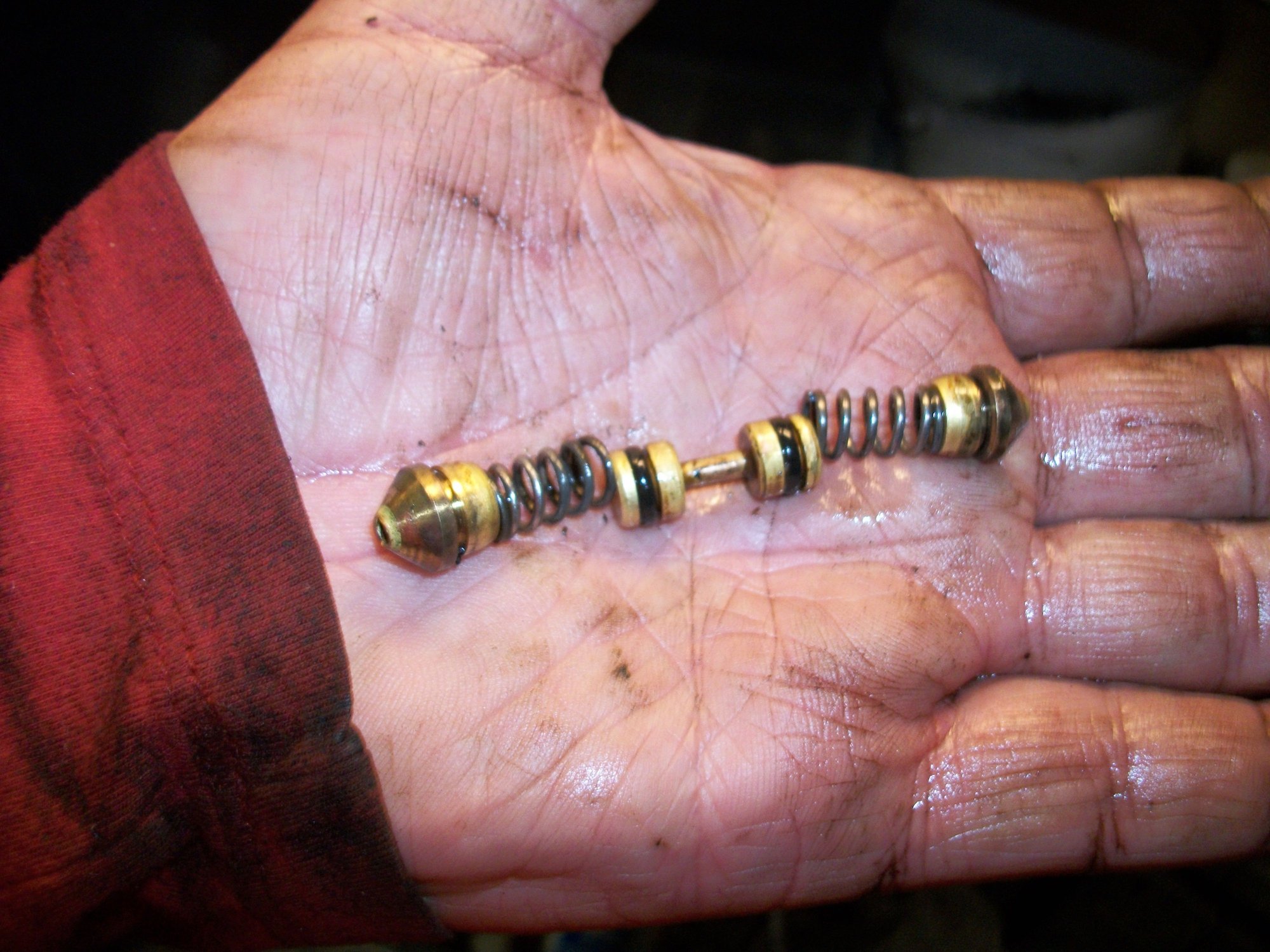

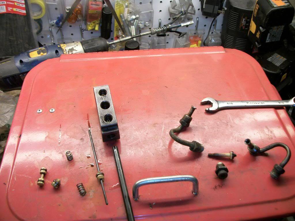

My 1968 distribution valve was stuck/gunked up internally/the piston would not return to center/the dash light stayed on. I disassembled it/cleaned it with new brake fluid/made sure there was still "tension" on the orings and the bore/reassembled everything...it works like new now........
What did you use to pull the cone seats out of the body?
(A recent NCRS forum tutorial shows cutting threads on the cones and using a small bolt and washers to pull them.)
I put a small diameter rod into the cone on one end until it seated against the back of the piston then I tapped the rod lightly with a hammer until the other cone and the piston popped out of the bore.
Then it was easy to see the back of the first cone which I tapped out with the rod.
Just take your time...it doesnt need hard taps to pop either cone out.
NOTE: You can see the small rod sticking thru one of the cones for reference.
