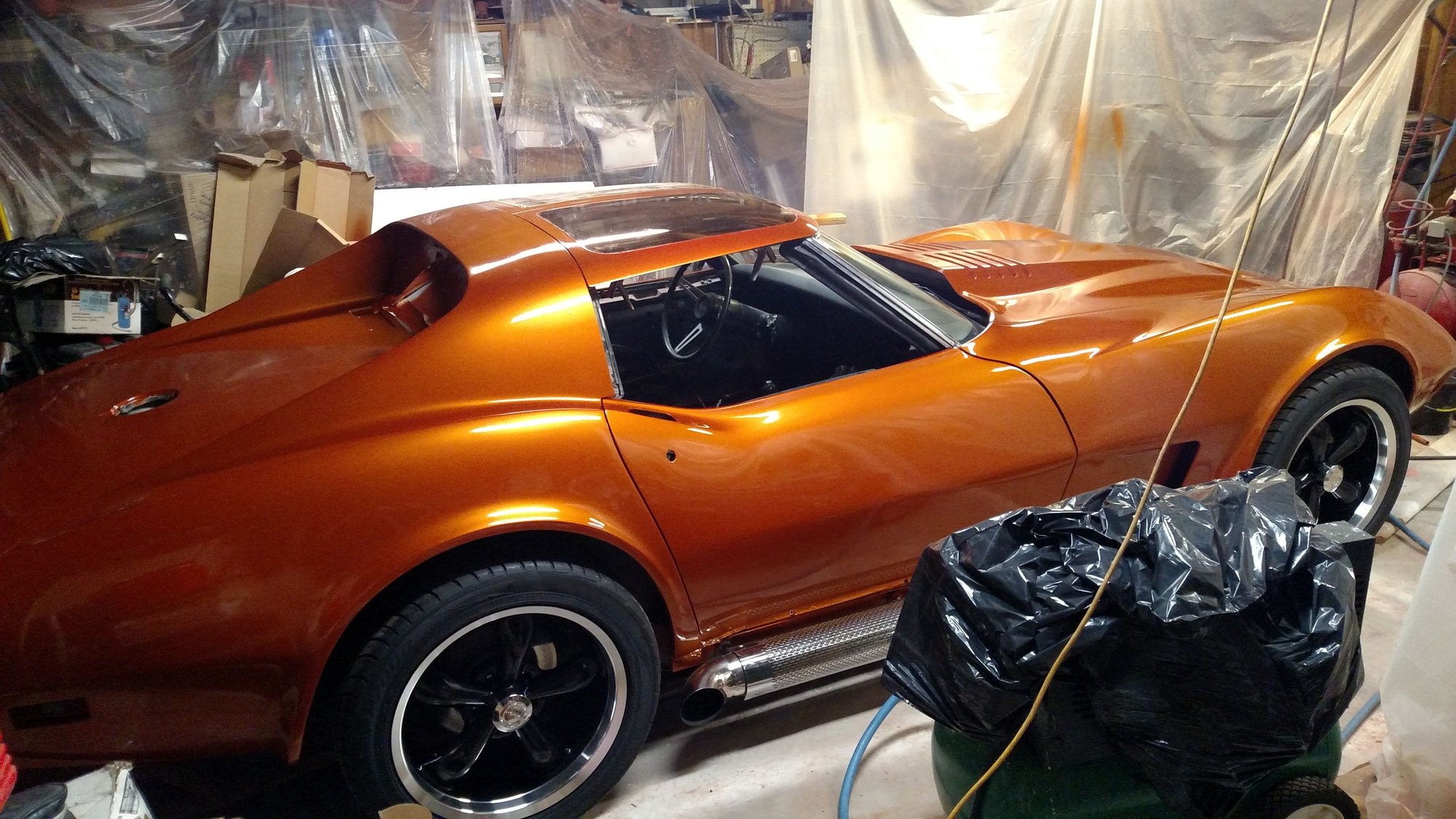

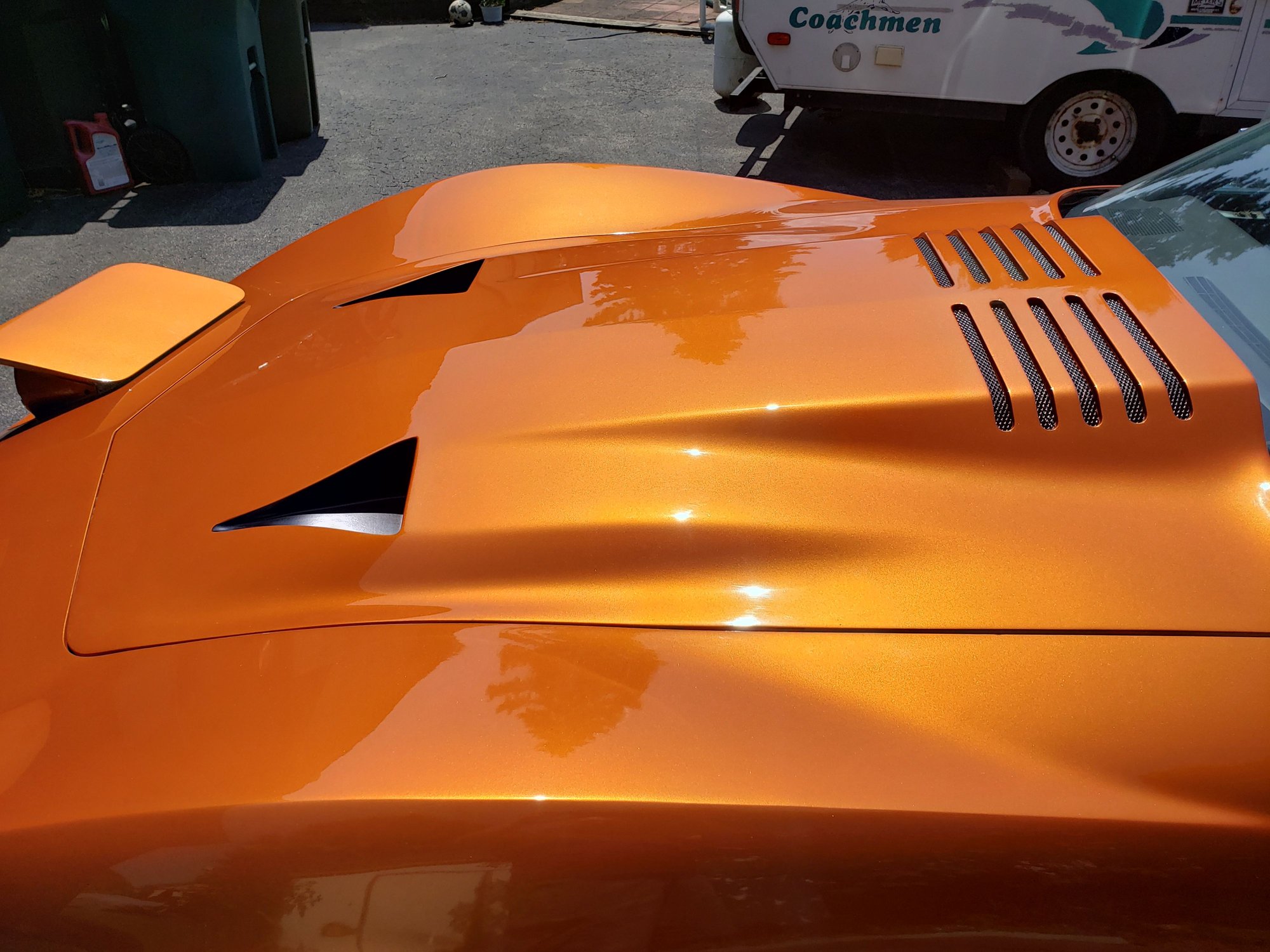

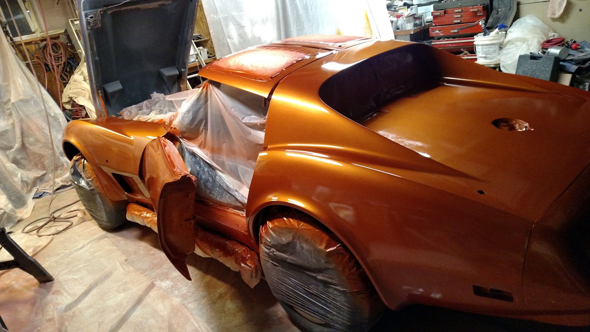

The real question many should be asking is what is so special about our fiberglass bodies that justifies such high painting costs?... Other than the Vette Tax I could not find anything... So I did my own paint and body work at home in my garage for under $800 (total cost including bodywork and primers and paint supplies) about $1100 if you include the cost of the second used air compressor, soda blaster and both harbor freight paint guns .... I had painted my old jeep wrangler and c4 before this. But I did not experience anything about the fiberglass or GRP bodies that made them more difficult to work on than the steel jeep body. Quite the opposite really since I didnt have to worry about rust repair or preventing it from returning. I found the fiberglass and vette filler compounds easy to work with even though I am a complete amateur so why do the pros seem to think its so difficult? most kit cars and dune buggies are gelcoated fiberglass and repaint /bodywork costs are not even in the same ballpark at most shops as a corvette. WHY? If I paid myself like $50 an hour it still wouldnt be anywhere close to what many of the shops are quoting and thats with the extra time it took me as an amateur.. My uncle worked at a body shop for years and he agreed its not always so much about covering the actual costs with profit but more about what you can get away with charging based on the stereotype/ profiling of the car owner. and those that dont use this philosophy simply end up overwhelmed with so much work they end up raising their priced due to that instead...
Now its been about 7 years since I painted the car and its not perfect (I have a couple small bubbles on the tops of the fenders likely from brake fluid contamination I failed to completely remove before the epoxy sealer and primers.)

I dont, but it wasnt as bad as everyone thinks. I worked on it for a few hours her and there over the course of 2 summers... if I had to guess id say maybe 80hrs. I dont make anywhere near 10k for 2 weeks work but my employer does charge $248 an hour for my skilled labor and even $200 an hour for my travel So I agree, doing it yourself of having a guy without ridiculous overhead do the work can = huge savings.
I dont understand what about fiberglass should make it more expensive than repairing a steel body.. That was my point, fiberglass repairs are much easier that repairing steel bodied vehicles.
