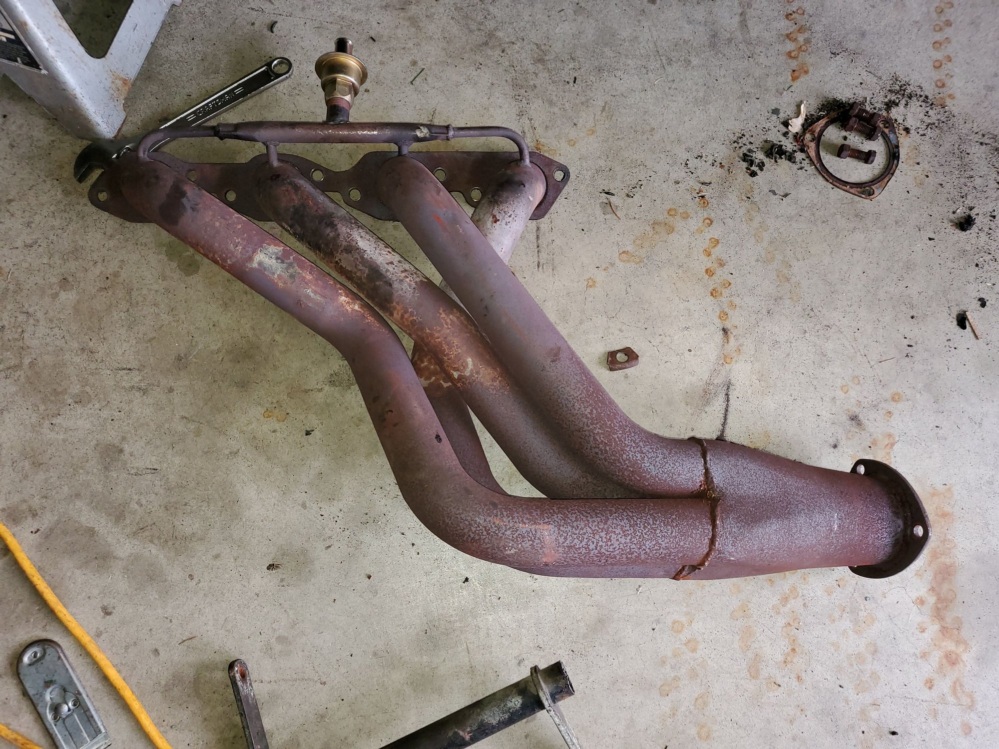

Well, I found my answer, the Borgeson looks like it will fit the headers but the welded on smog pump attachments do not fit. Guess I will be buying new headers. That said, I will have a complete smog pump setup with headers available for sale. I was really sweating the clutch cross shaft.

I'd be curious if anyone can positively identify these headers. I thought they were Hooker, but comparing the tube bends, not so sure now and I am back to my original dilemma, will Borgeson fit with Hooker Super Comp.

You are very lucky those are one off factory headers they are worth more then the car

Thanks @JohnRR I think I have identified my current headers and based on the stamp on the flange and side by side, it looks like mine were 2" Hedman. Oddly it appeared that it was the smog pipes that caused the only interference, but quite concerned to go buy another set to not have them fit. Did you find a header that worked with the Borgeson, or did you manifolds?
