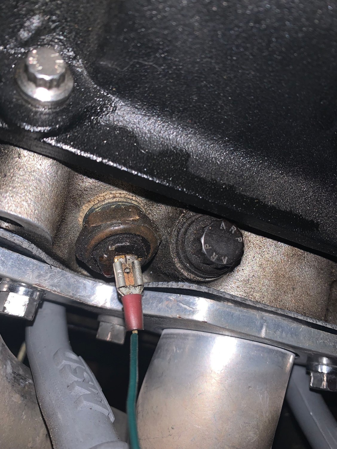

I would try cutting clearance but I might even remove it
so,,
After looking closer, even removing the head bolt wont help. the socket will still hit the head casting. if you zoom in you can see the casting is the problem not the bolt

Originally Posted by Jebbysan
Take a socket and grind it thin...or have a machinist friend put it in a lathe and reduce the wall thickness.....Pearl Harbor Freight has sockets for like $3......
You could take a dremmel with a disc and gring some off the head bolt boss too.....carefully......a steady hand can even blend it a bit as to not look cut or ground on......
From the pic it appears that removing the head bolt will gain zero as the sender is sunk in too far.....
Jebby
Thanks man. I agree. Removing the head bolt does nothing. Someone also said these are the wrong head bolts. I dont know. They were installed 5,000 miles ago and haven't had any issues other than this sensor. I appreciate your help as Im not a mechanic.

Originally Posted by 7T3stinger
it’s a head bolt is all I know. Edelbrock heads.

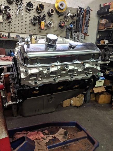

Not sure about the head bolt. They are all like that. Was installed when the engine was built by a performance shop 5,000 miles ago. Here's a pic.
I see. Yes, these head castings are different from stock. I wonder if Edelbrock has an extended sender unit to work with these heads...
Good question. Will look into it. Thanks I still have to get that sucker out ha ha.

Here is my temperature sensor socket. Forget the size and it isn't marked.
Edit: OK, I looked it up. It is a Kolbalt 337742 which is 15/16" socket, 1/2" drive. I cut off the part with the marking.
Anyway, 12 point socket with about 25% cut away. Temperature sensor is NPT tapered thread so get about two to three slight turns on it and it will come right out.

Here is the sensor from my original L-48 installed in the Edelbrock heads of my 496. (That way the garage is accurate). My modded socket worked great. 20k miles, no issues.
Wow. Thanks for the tip! I appreciate it

OK. I see the problem is the casting, not the bolt.
The modified socket would be my next suggestion. You might be able to get it with a crows foot, but you'll definitely be able to knock it loose with the modified socket.
And I'd look for a 1/2 NPT bushing and try to find a 1/4 NPT or 1/8 NPT temperature sender if you're going to use those heads. Get the busing in tight, and if you ever have to replace the sender, it'll be small enough to get a wrench on it.
