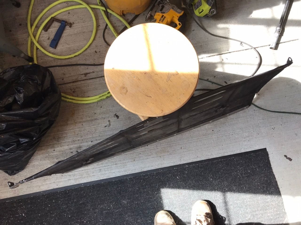

Has anyone ever come up with a way to un warp these fibreboard rear trays.
I would like to try and keep it as original as possible. Thanks in advance

Support the ends of the tray and place a weight on the high point. Using a wallpaper streamer, carefully steam the underside until you start to see movement. Monitor this movement carefully to avoid the tray bending in the opposite direction. Have some smaller weights ready to switch out as necessary. Be patient. Apply the stream uniformly as possible, ensuring you are streaming the full extent of the bend and not over applying it to one area. Once you feel you have achieved the original profile, place a support under the tray at the point of the weight and let it sit for a day or two to see if it retains the profile. You may have to repeat the process, adjusting as necessary to obtain the desired results.

the last 2 i did were warped BAD i put in the basement and used 2x4 scrap to lift it off the ground and put pressure on it where it was warped for weeks. got better but not perfect, repeated out in the sun for a day, and they have been perfect since steam or heat is seems to be the way
if you decide to Reflock the one side, i just ordered a reflock kit off ebay and did my compartment tray, heres what i learned.....
-wear a mask
-put more acrylic paint down then you think you need and dont leave wet lines
-DON'T TOUCH IT OR ADD MORE ONCE THE FLOCKING IS APPLIED ()

Ok thanks for the replies, I will give it a try this week. It seems to be in to good of condition to get rid of.
