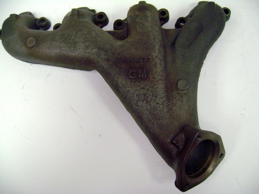

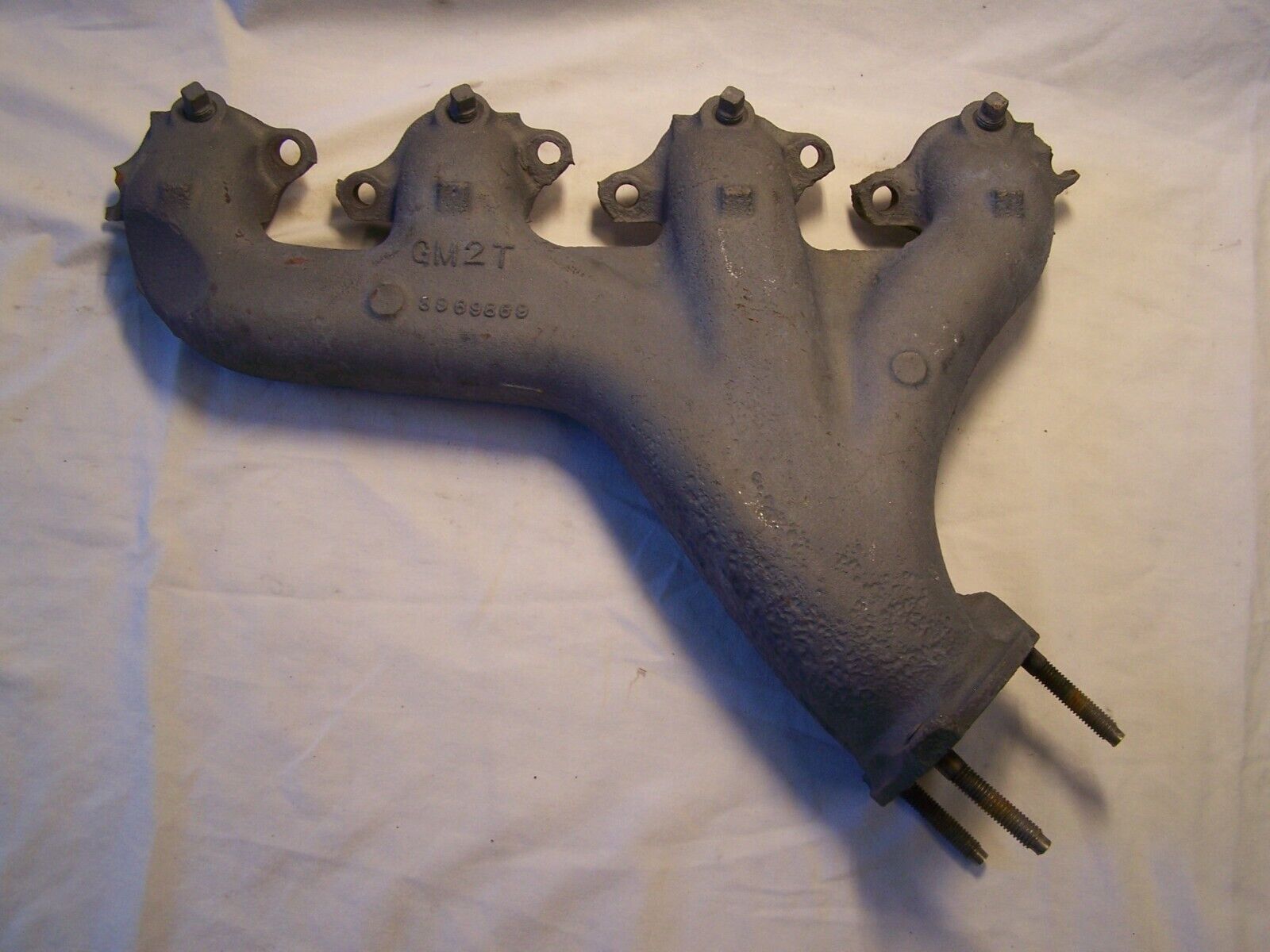

To the best of my knowledge, the passenger side is the same from 68-74 BB vettes of any size
The drivers side changed in 70 (with the 454) and the exit is more straight down where the earlier were kicked to the outside more
66-69
70-74
