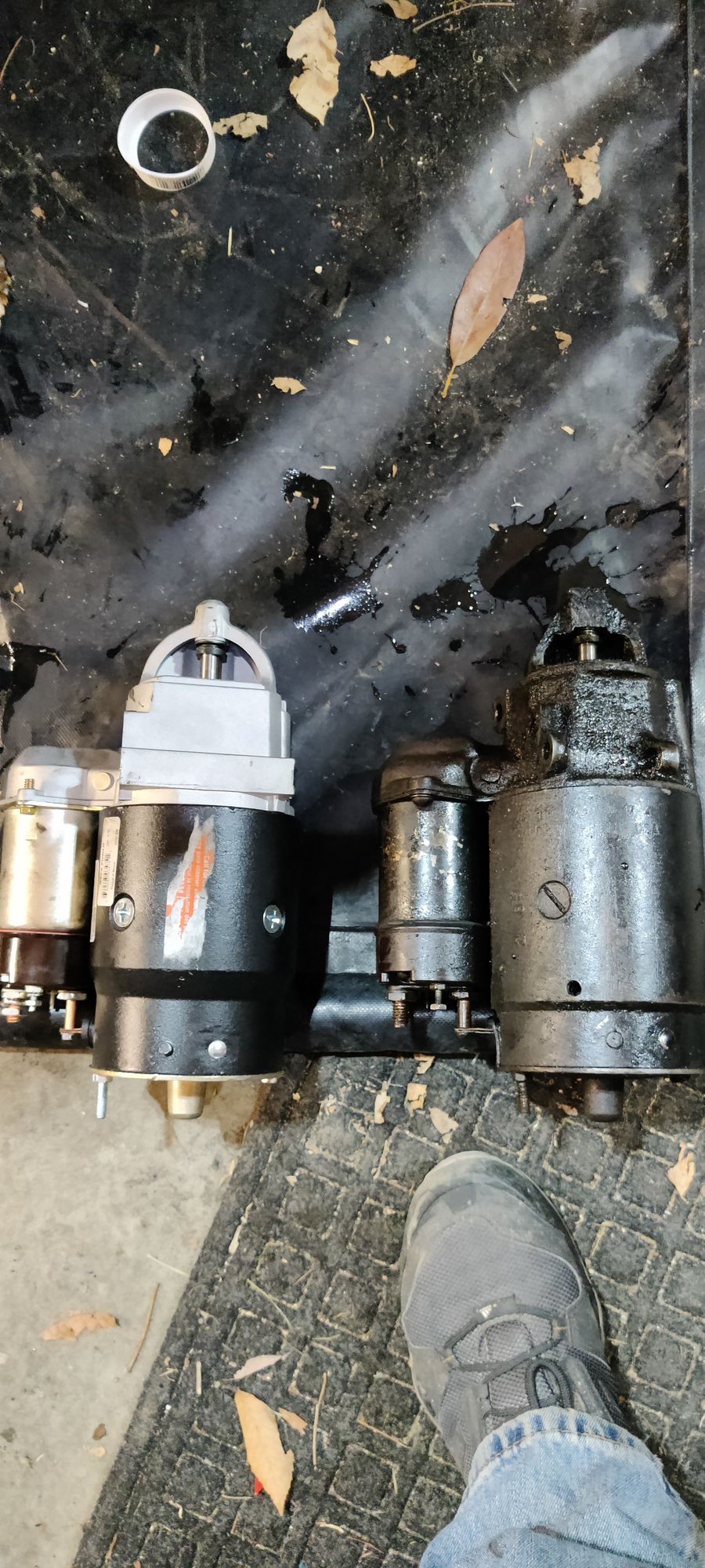

Hi everyone, I have a 454 with block casting number 3999289. I purchased a new starter and it didn't fit. Turns out the "nose" of new starter is about 0.5 inches wider (see pic). I tried putting in different years and models of Chevys that had the 454 but I keep getting pointed to the same wrong part. Any idea on what I need to buy? I can't seem to find anywhere where this dimension is detailed.

Some have this difference for automatic vs clutch because of the bellhousing. I have run into this before. If you can’t get the correct one you should be able to swap the starter nose to clear.
Good point. Just reuse the cast iron nose cone that does fit.

Hi everyone, thanks for the all the input. I wanted to follow-up with the solution I found in case someone finds this thread in the future.
It turns out there are two different starters for the 454: one for an automatic transmission, one for manual. The bubble for the starter in the bell housing is a different size in each. The smaller, cast iron nose is for the manual and the larger, aluminum nose is for the automatic. Online the parts stores don't make this distinction; they're all "guaranteed to fit" and there is no indication which transmission they are for. I went into my local NAPA and on their internal system they do make the distinction. I was able to return the one I had and get the right one. All is good!
