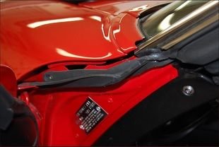

Photo from the Alan 71 collection:

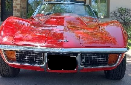

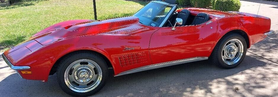

Here are a few other pictures of the outside of the car. Hope this helps.
Thank you for all of the replies!!

Beautiful '70 Convertible! You can't beat Red on Black....stunning.

Nice looking car! I was wrong when I suggested someone had put on a front clip, but they certainly worked on the area you are concerned about to fiberglass in the fender extensions to the windshield so as to blend with the long-style hood. Following Peterbuilt's advice to clean, seal, (and paint) is good. It appears you can get to the back of this area through the windshield trough area, so clean and paint that side too.
