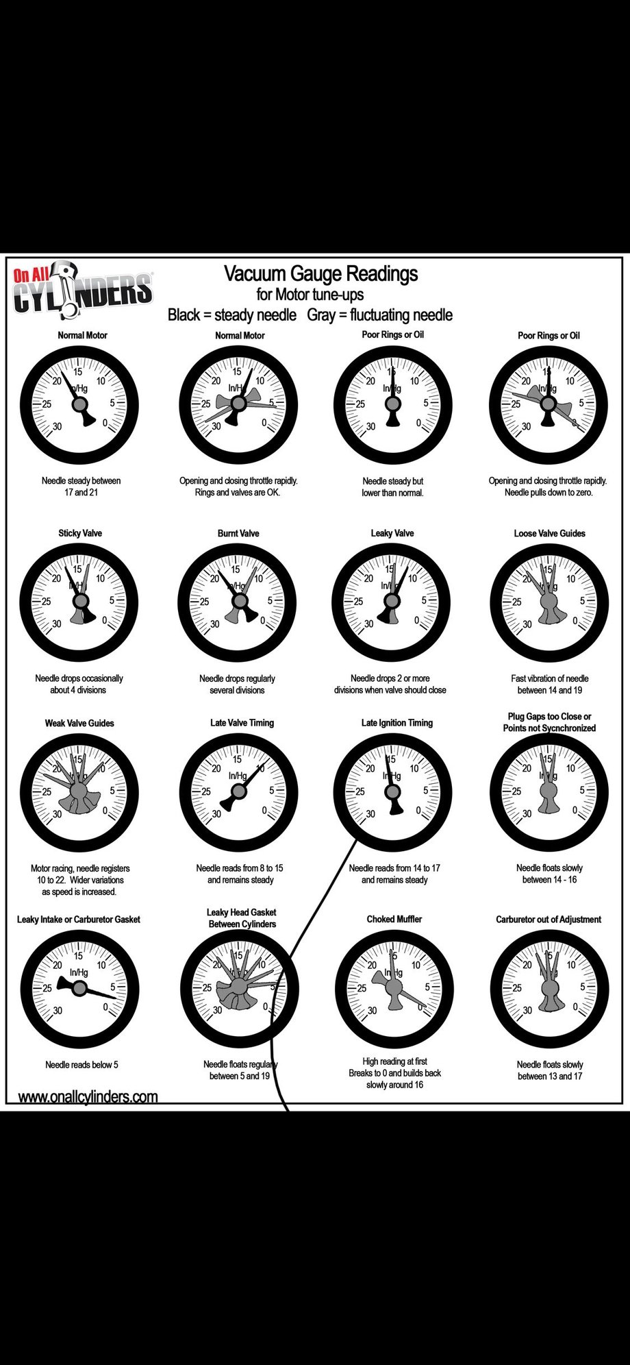

Maybe this will help.

I found a diagram (similar to the one posted above) that made me wonder if it was was valve issue, too. Like I said I'm too new at all this to narrow it down.
Thanks! I found one similar to this diagram also, just trying to get someone more experienced than myself to narrow it down some more. Seems like one of two valve issues, either sticky valve or loose valve guides,, maybe? Thoughts?
