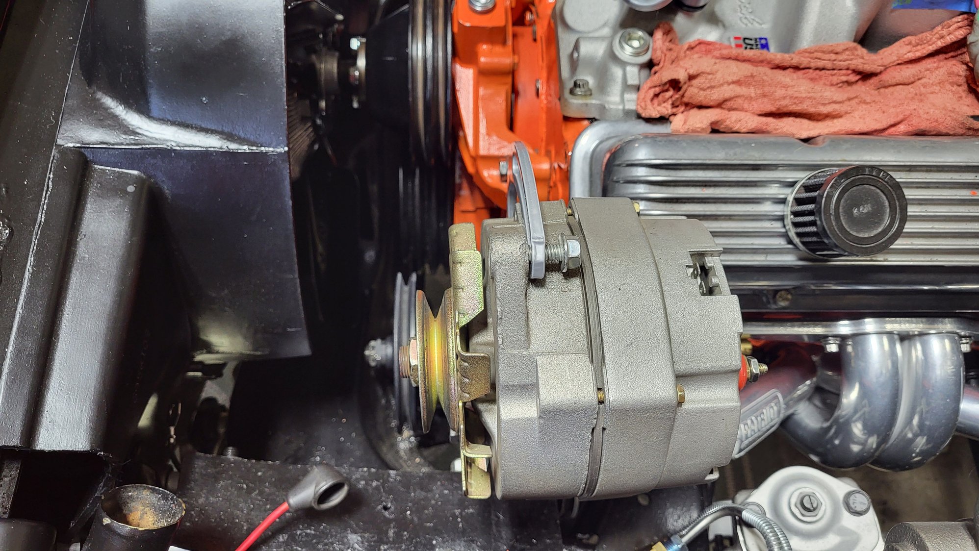

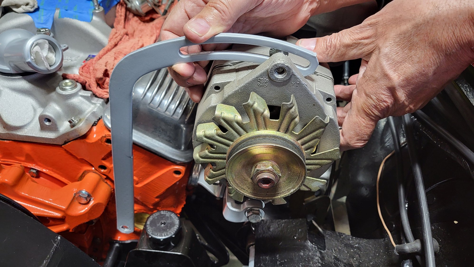

Hey All,
The Vette is a 1970, small block, 4-speed, A/C.
I bought a complete exhaust system from Corvette Central that included Patriot shorty headers and a full 2-1/2" exhaust system that goes out the back. The problem is that the alternator brackets that Corvette Central supplied moves the alternator away from the engine such that the stock overhead adjustment bracket doesn't line up.
Can someone please post some pictures of how you installed your alternator with shorty headers?
Thanks,
John
When mounted to the water pump, the geometry is wrong and the alternator can't rotate to tighten the belt.
