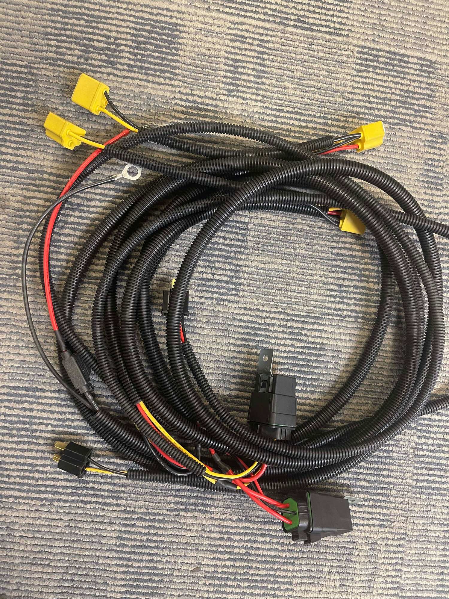

Does anyone know if Dapper Lighting upgraded their 575 relay harness?
See post #4. https://www.corvetteforum.com/forums...-readings.html
See post 12 of the same thread:
Hey there! Thanks for taking the time to evaluate our products. We spend a lot of effort revising and improving products and your feedback is definitely appreciated! When you messaged us the first time, we sent that over to the EE and he looked over the harness and agreed that the gauge should be 12-14AWG. It looks like this harness originally didn't do all four high beam and was adapted to do so without revising the gauges. We're happy to swap you over to the new harness when they are completed. We've also put in a request to swap them to the traditional Bosch 4 pin relays but that's a matter of setting up the supply and getting stock.
As for the headlights themselves, we've moved away from HID as many many customers have experienced issues with HIDs in their classic cars. While they do perform better than LED, it's simply too complex to troubleshoot these issues when many customers are still running stock wiring harnesses and prefer not to run relay harnesses.

I understand that they said they were going to upgrade the harness, but they do not answer emails when asked about the wiring sizes used in the harness. Which leads me to believe, the harness is still under wired.

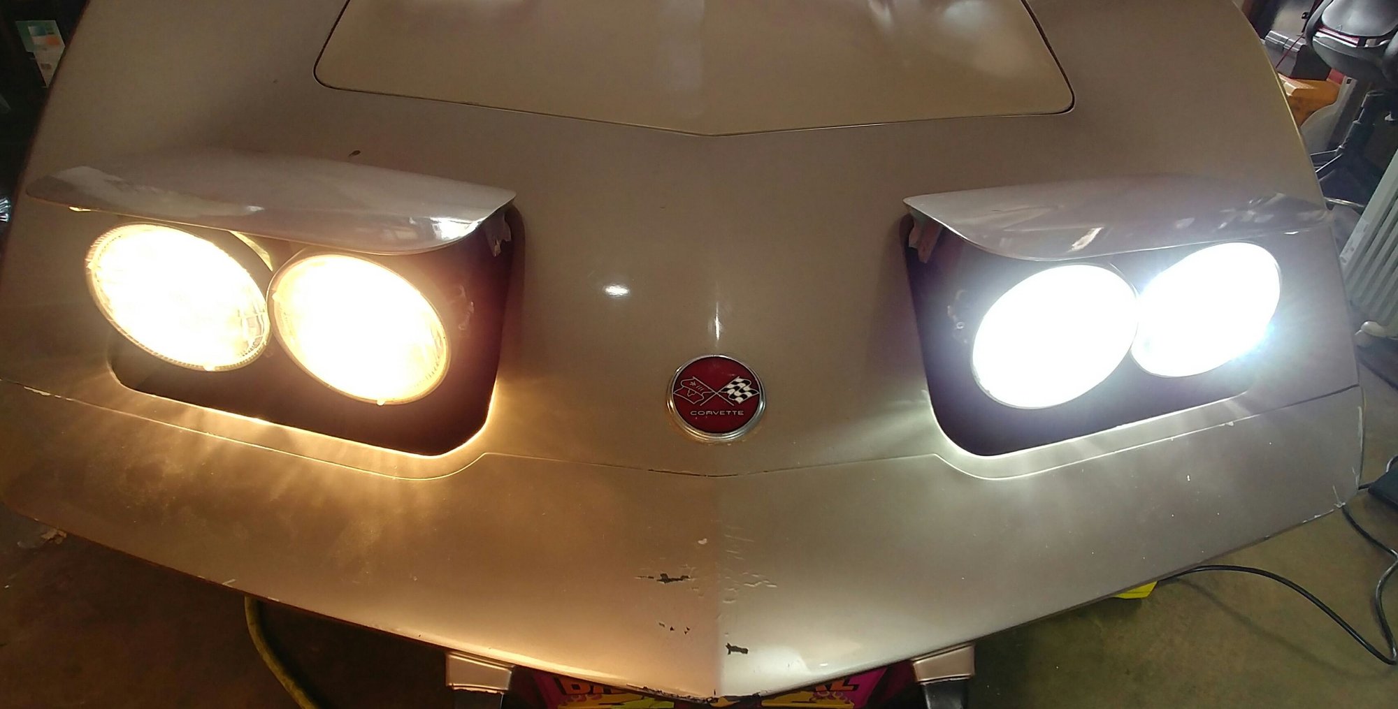

while the look isnt for everyone these led lights are an option They draw less current than the stock lights and are much much brighter. they have a good projector style low beam and bright highs too. the halos flash orange with the blinkers for added safety/ making turns easier to see.

Originally Posted by Hazmatr
Yep. That is the email I used. I got no reply to my question about the wiring sizes used in the 575 relay harness.
I apologize if the rep wasn't clear in the response. They haven't been informed on the upcoming product changes. We have a new harness that is designed out with samples, but we have to move through our old stock.
~90% of our orders are all for LED kits which don't have any issues with the old harness. Because most people have switched to LEDs, we sell very few harnesses now so there hasn't been a ton of need to switch over yet. I can do small run of them if there is some interest though.
The "new" harness is swapped to a 14AWG on the supply side, 14AWG on the mains, 16AWG on the signal side. We've also upgraded to 40A Bosch style waterproof relays and female H4 connectors. The downside is cost went up significantly (guessing ~$79-99 retail).
If someone wants to give them a test, feel free to email me and we can have you review them: ben@dapperlighting.com.
Appreciate everyone's feedback and comments. Helps keep us continually improve our products. PS: Sorry for the awful picture but it should give you an idea.
Cheers!
