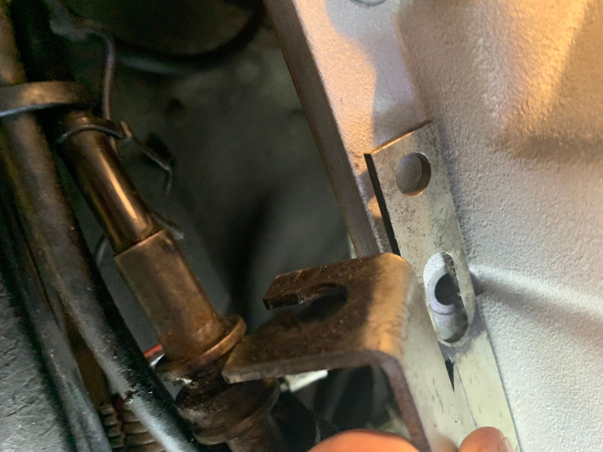

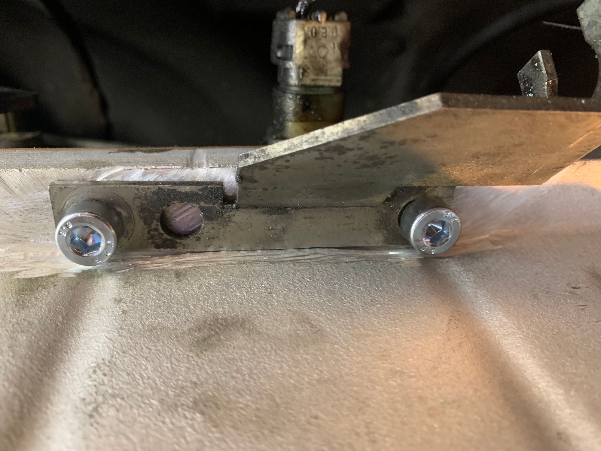

2003 I installed the level 2 Transmission from Bow tie Overdrives. I installed the B&M controller a few years later which has worked really well.
I noticed my trans pan gasket leaking a little this year so I decided to replace the filter and gasket. The while you’re at it kicked in so I purchased an aluminum trans pan. The only issue I had is that the cast aluminum pan is thicker then the steel pan was so the shifter bracket would not fit to the bolt holes so I had to modify the bracket by grinding some of the inside edge so I could get the bolts back into the holes.
just an fyi for those that might have thought about doing the same thing.

The casting holds the bracket away so the bolts won’t go in the holes
I ground the casting between the bolt holes to get a flat line. Then I cut the bracket until the bolts lined up with the holes

When i had my TH400 rebuilt a couple years ago i had an aluminum pan put on it. not only did we have to grind the bracket to get the holes to line up but also had to bend the interlock cable bracket. becasue the pan was thicker it moved that cable enough that my ignition key require much greater effort to turn it.
