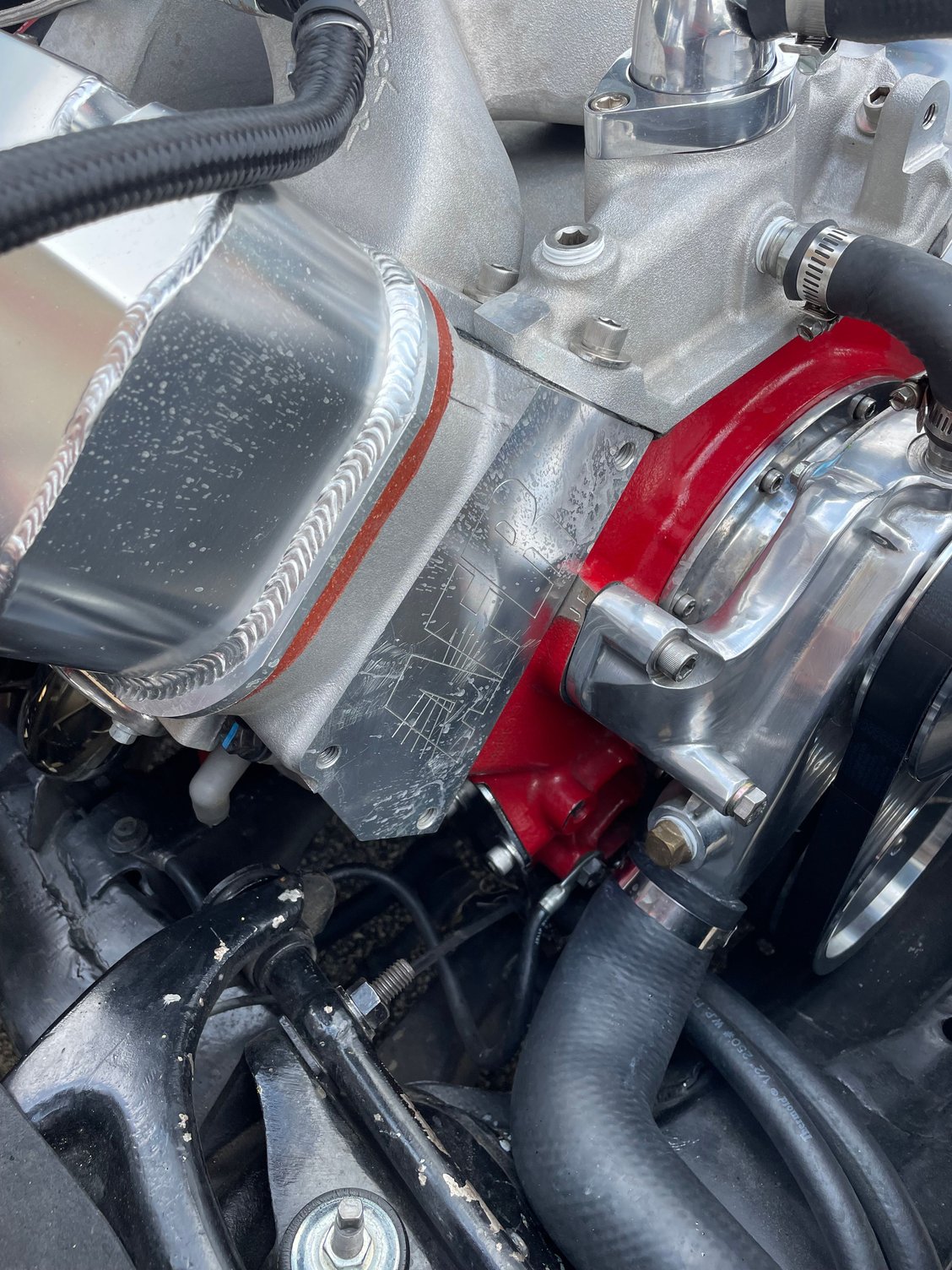

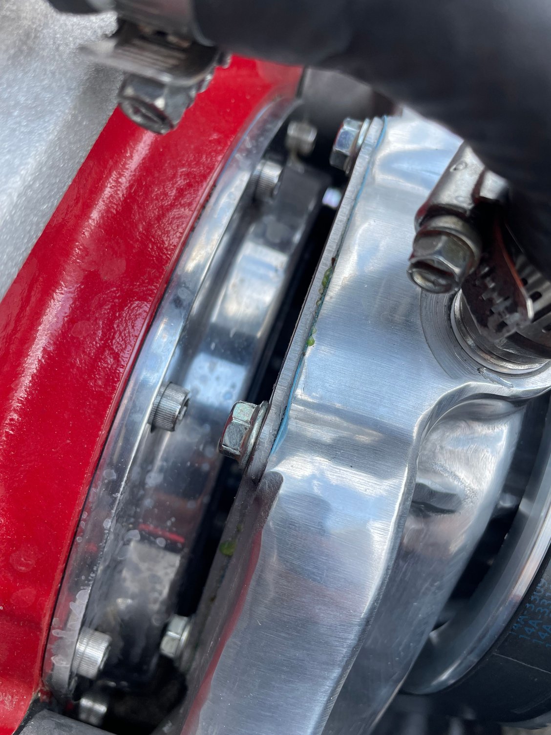

So got everything up and running actually made a car show last weekend I was shooting for. However the car went from the shop to the trailer, to the covered booth it was in, lol. I been fighting power steering leaks so no power steering, and barely zero Road time. I bought some really nice stainless steel lines to convert the type 2 power steering pump to the factory slave cylinder. Well today I think I got that fixed, had to take the line apart and reinsert the brass crimp fitting.
went for the first real drive just now, a little Hwy and a Littel town action to hit some traffic and see if she stayed cool. All looks good, it definitely likes both cooling fans on but that may also be a function of not having a hood. I pulled over to look at everything and noticed coolant on my head and what look like coolant at the backing plate of the pump. Made it home no problem so no idea why it pushed some out but appeared to seal back up.
I fought this when I first got the engine running, the first test drive it blew the gasket on the backing plate of the water pump. Had to tow it home which is always fun. I read on this forum where someone had the same issue with their Proform pump. I ended up putting a Felpro gasket on it and it did it again. This was mostly my fault because I wasn't running a pump bypass line so it was building pressure and blowing the gasket. I been an SBC guy all my life, first BBC so I learned something!
well a few weeks ago, I got Summit to send me another pump (same kind) and immediately changed the gasket to a Felpro because they come with that cheap cardboard crap. I
now installed a bypass line and I went to that show last weekend. Well just after my drive today I see this coolant on the head in the pic below. It is for sure still coming from the pump gasket.
Now I don’t think I can trust this thing, so I am thinking of going to a different pump all together. I am considering the Edelbrock unit, while double the cost of this pump at $400 it’s pricey but maybe better?????
anyone have a similar issue? Got any suggestions or experience with other pumps?

Have you tried laying a flat edge across the pump machined surfaces? Is it really flat? Maybe run a file across it to see if it makes good contact. Pump and plate.
It's not a bypass issue. I haven't run one on mine for 20 years spinning 8K RPM regularly with stock pulleys.

Danish Shark might be on to something here.
Hard to tell in the photo but it looks like the W.P. is truly contacting the timing cover bolts. So when you think you are torquing down the W.P. bolts against the block for a good seal, in reality the gaskets are not sealing. It would be equal to finger-tight bolts.
That is one thick timing cover. See if you can even get a piece of paper between W.P. back cover & timing cover bolts.
I have seen in some circumstances where a thin spacer moves the W.P. forward. Of course this effects all pulley alignments.
You can likely use that W.P. Just pull it off again and take one of back plate bolts to the hardware store. Look for something flatter.

It for sure is really close but it doesn’t touch, after I had the pump off the first time I looked at it closely, can’t get a piece of paper in there but it’s not touching. I like that the Edelbrock uses flat bolts, more clearance is not a bad thing.

On a '69 model, as long as you get a short pump with the 5/8'' pilot shaft you are OK. (Make sure your pulley is for the 5/8'' shaft)
The "Corvette specific" thing is for later 3/4'' pilot shaft models, where Chevy generally started using the long pump, but made a Corvette specific short pump with the 3/4'' diameter pilot shaft
