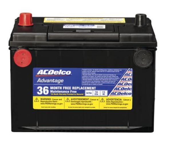

Tim -- I installed Dual Terminal (DT) AC Delco batteries in my C3's because it is easy to hook up jumper cables or a battery maintainer to the top posts. Hooking up jumper cables to side terminal bolts usually results in bolt heads that get messed up, or a lousy connection when you try to jump the car.
AC Delco makes a 75 series and a 78 series DT battery. Select the one that suits your needs. They have a convenient handle that folds flat out of the way. This pic is of a 78 series.
I put these DT batteries in all of my other vehicles as well. They last about 4-6 years depending on the vehicle and the usage.
