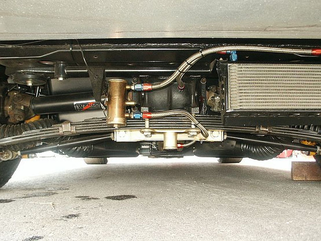

You do understand that lower numerical number differentials run cooler? How much power you are putting to it makes a big difference. My advice is when you pull into the pits after a session of lots of hot laps, get out the temp gun to get the hottest point on the case. I found that my 4.11 ran cooler with 75W-140 syn power. But generally I never got much over 245 degrees. I debated on a manual tranny and diff cooler like this vette I used to work on.
I always wanted to weld up the centered jacking point on my Vette.
Gary R. also pointed out that this is NOT plumed correctly. It should spray from the side of the cover aimed at the ring gear. This is Vic Edelbrocks old vette back when he was still racing and it does have a nice pusher fan setup through the radiator.

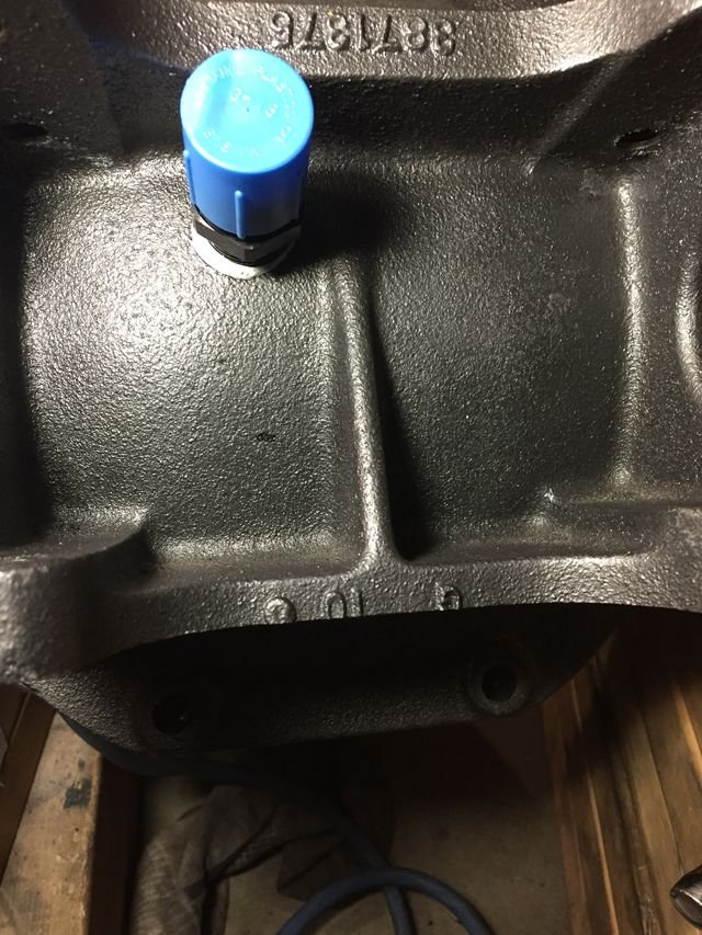

Drain added same location as yours.
Fill entry here. Which looks like entry is direct at the gears.

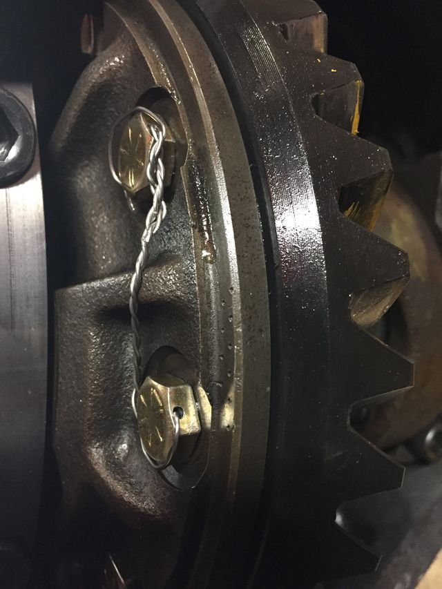

They also added the wire support since I have had bolts come loose and drop into the diff. ( not sure if this was a good idea ) but I did read about others having similar problems.

I took apart a customer rear end and half the bolts were loose. I've always used red Loctite and ARP bolts and never had a problem.

Is the wire over kill ? or another problem waiting to happen. Diff builder added this.
