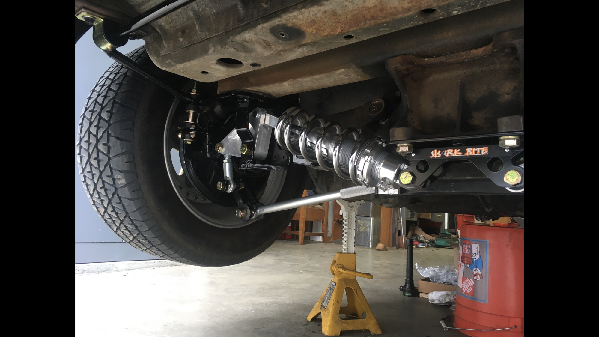

For those with rear sharkbite coil over system installed.
I just finished installing mine and before I get it off the lift I was wondering what setting you had the shocks at. I know I will be making adjustments but am just looking for a starting point. Thanks

I'm at 3 clicks compression and 4 clicks rebound. I try and match it to the front which are single adjustable so that they seem in sync.
If you go too high the rear end will bounce like a lowered Civic LOL.

I started at the softest and worked my way up. As above I ended up at 3 or 4. It starts getting pretty intolerable after that lol.
Not much love for this system around these parts. I like it on my 75 bastardo that much I can say.
