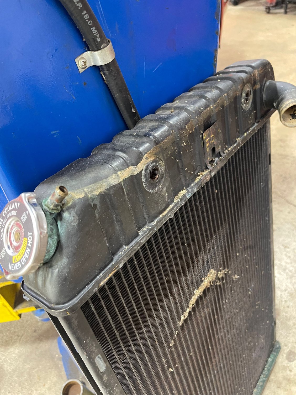

My radiator developed several leaks and there was more and more coolant on the garage floor after every drive. My mechanic is installing a new all aluminum DeWittes radiator.

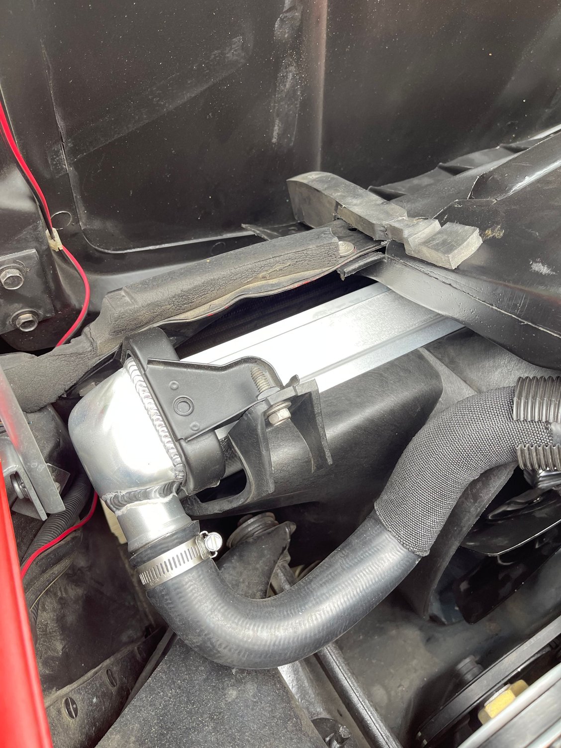

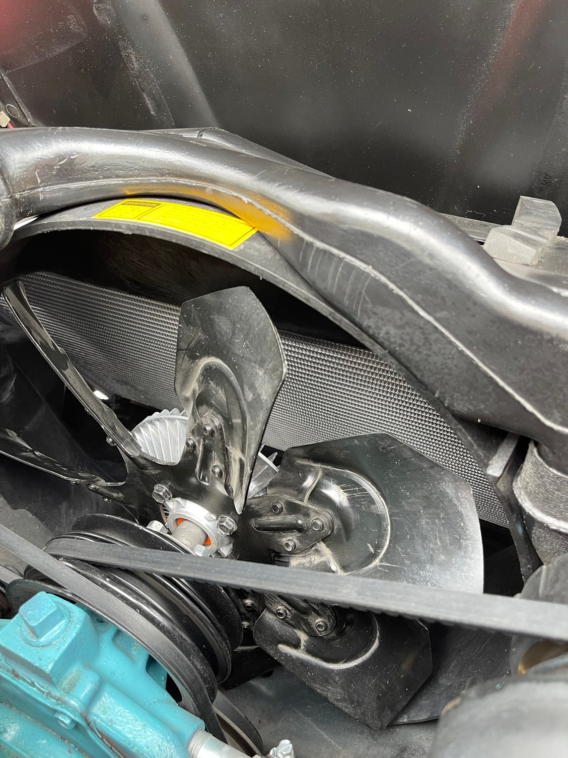

The new radiator is in and the engine is running much cooler. This was after driving on the highway for a 1/2 hour with the A/C on. The red line is typically where the temp ran. You can also see the new fan clutch. I’m looking forward to driving in the heat of August.

who/what make is the radiator?
Old May 16, 2023 | 08:10 PM
JiminSTLouis's Avatar
JiminSTLouis
Joined: Apr 2022
Posts: 276
Likes: 290
From: in St. Louis
DeWitts direct fit 1139077A

Old May 16, 2023 | 10:06 PM

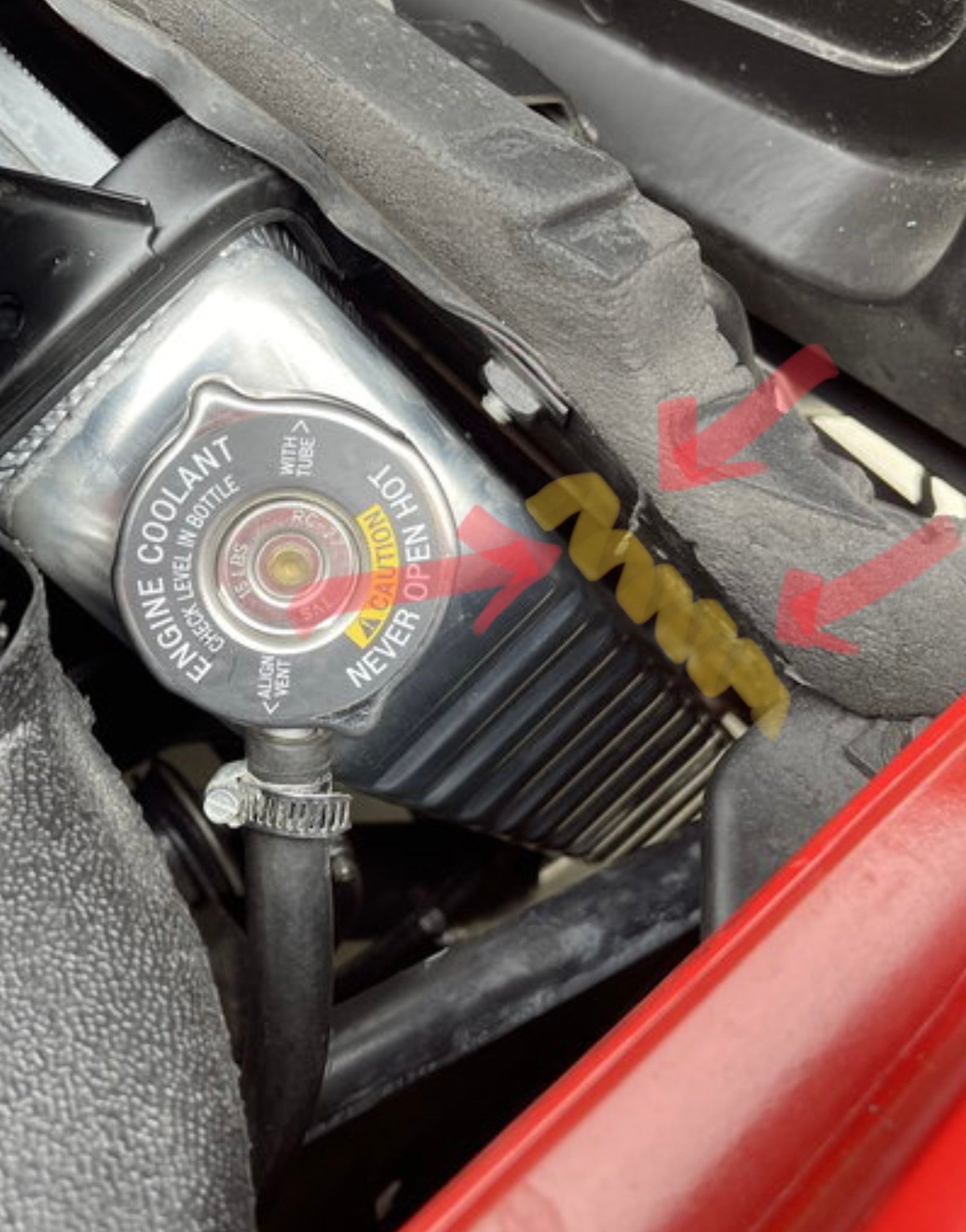

couple thoughts..are you sure there is a thermostat in there? It looks pretty low.
you may want to add a seal on the sides in front of radiator to help direct air.
My mechanic put a 160 degree thermostat in because I reported overheating in the summer months and hard starts after extended driving.

Cool..may want 180f but if heater works what the heck. A lower thermostat seems odd for hot running car.
if you fill this gap it will help draw air through radiator
