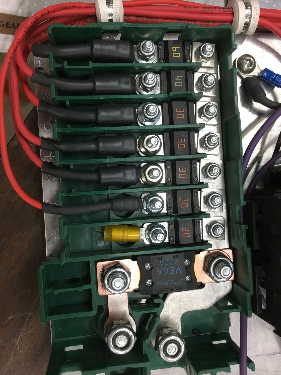

Originally Posted by righthanddrive
Success ! I was at the salvage yard looking for another part, and ran across a 2004 BMW X5 that has the battery located in the rear of the car. I asked how much for the cable and was told $10 . ...Ed
I've raided 3 BMW's at yards so for. Excellent quality wire, and HD fuse panels in Series 5's that can be used to support cooling fans, fuel pumps and other relays, etc.
