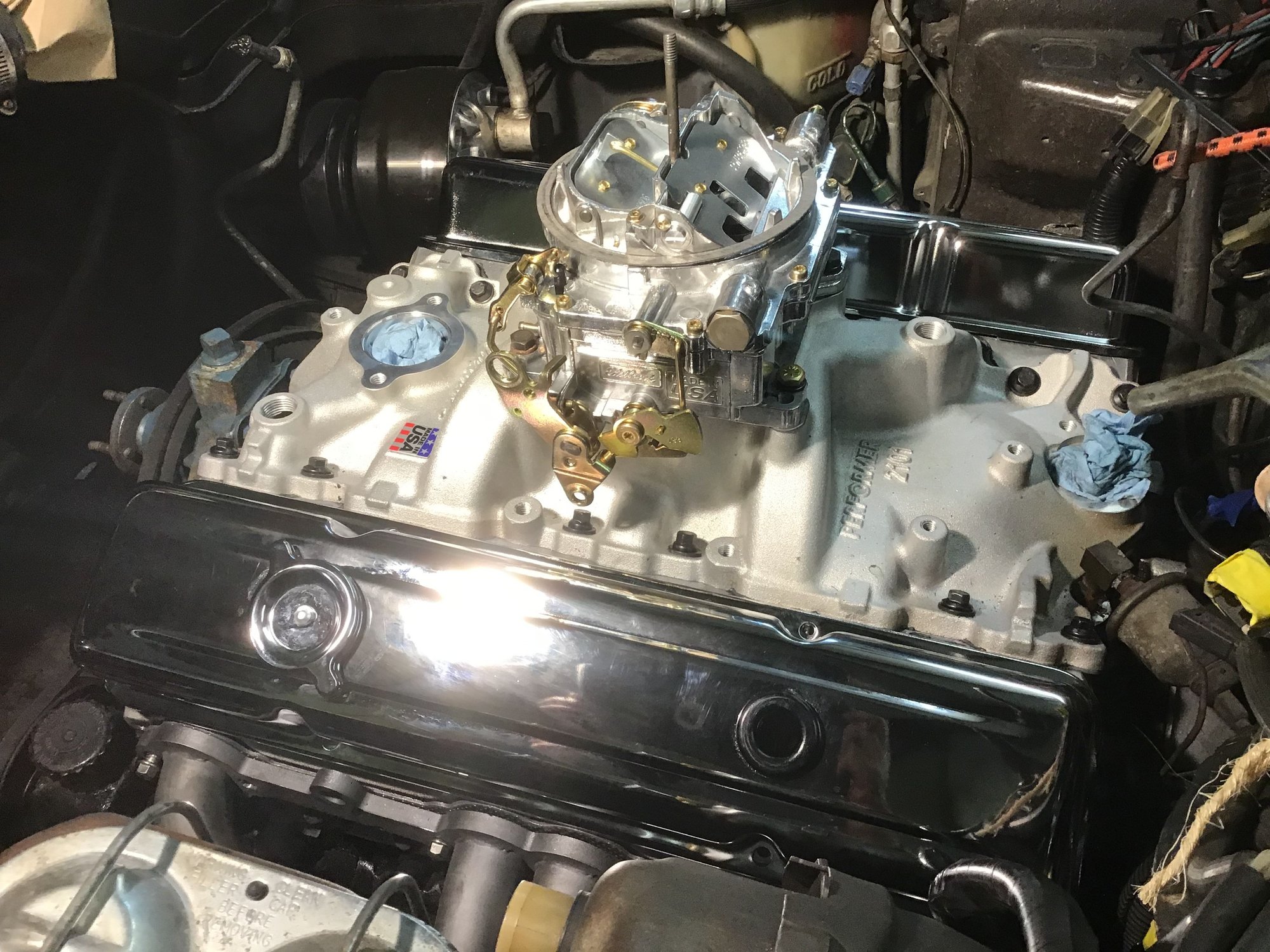

I have posted on my profile several times,not sure why it doesn’t show up. It’s a 1981 with 80k original miles,and was stock about a year ago but since have E street aluminum heads,Edelbrock intake,AVS carburetor,and added a comp cam 262,and replaced oil pump,new bearings.and have a 200-4R transmission to replace the th350,and Monday should be receiving a new 3.54 differential to replace the original 2,87 gears.

Old May 18, 2023 | 10:02 PM
Peterbuilt's Avatar
Peterbuilt
Joined: Aug 2006
Posts: 7,427
Likes: 1,560
From: mount holly NC
You might want to put the valve cover on facing the correct way as you put it back on.
