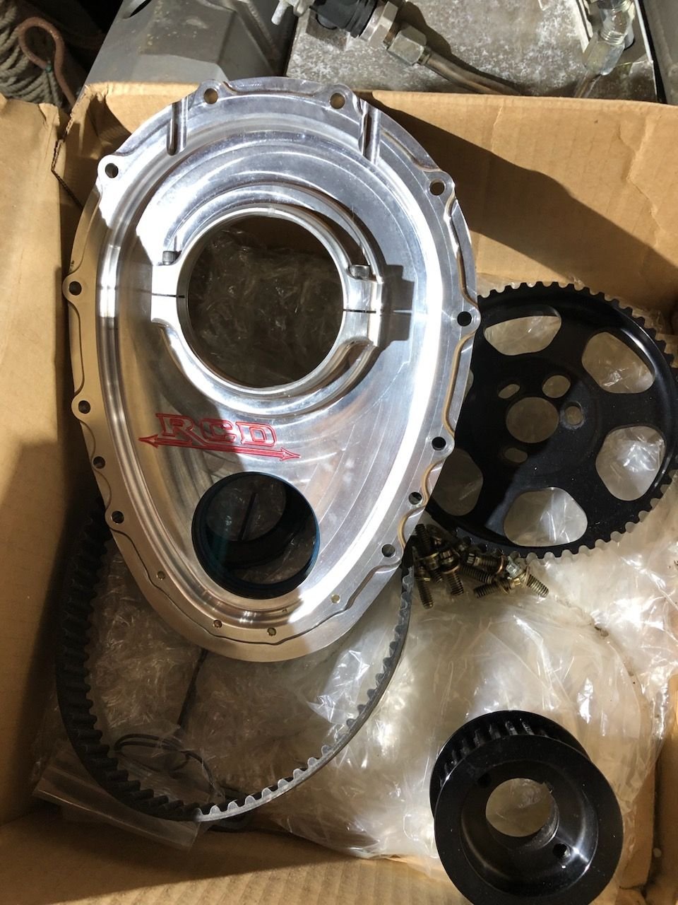

Just stumbled across another thread & someone mentioned using a belt drive & bolting a wheel on front of cam gear, sounds like a simple solution.
Just so happens I have a RCD Engineering belt drive I bought many years ago.
Pros & Cons everyone ?

I just found my solution I believe = run a belt drive for timing & bolt a trigger to the front of it, I'm thinking this is the direction I'm headed
