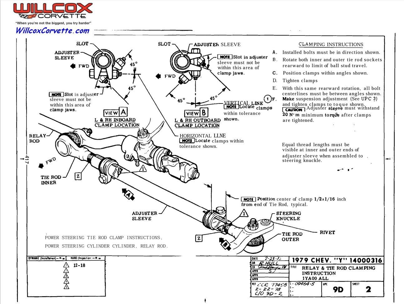

79.. imagine would be the same.. i do not see different specs for optional tire size... might as well show them where the bolts go to..
