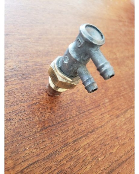

Can anyone please tell me what this plastic piece is attached to the front of the intake manifold adjacent to the thermostat housing?? It has a spring and pin that sits inside it. It broken and needs replacement if someone can point me in the right direction. Thx!

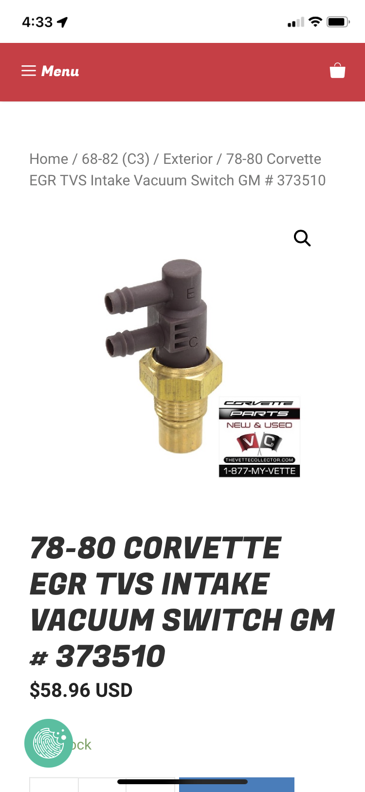

Thermal vacuum switch for EGR.

It’s an easy replacement. May loose some coolant when you change it out.

Brother, I think $60 plus tax & shipping is a total burn for this $5 part!
I have a good used one I just took off my clean Southern California car. PM me your shipping address and I'll give it to you.
