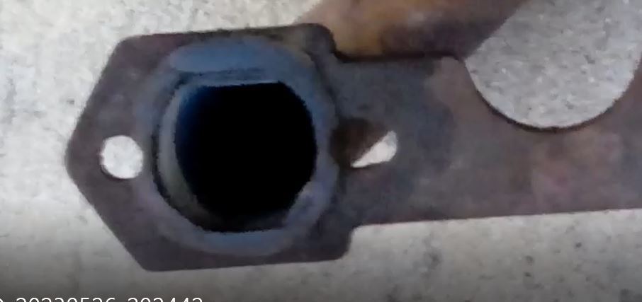

Hi everyone, I'm trying to figure out what header gaskets I need for my 76. There is a so much data out there that it's getting mind boggling so I thought I'd just ask. I don't have any idea what brand my headers are. They came with the car.
Can anyone confirm the port for my header in the attached picture is considered "round"? Also, how do you measure the port sizes? What would be a good choice for a replacement gasket for a stock street car? Thanks.

1404 Fel Pro exhaust Gaskets, Steel Core Laminate.

Looks like I'm barely seeing "Cyclone" and "Engineered by..." stamped on the side of one of the headers. How do I measure the ports? Would mine be considered round from this picture?

Took one of my headers to a Speed shop here in town to get sized up for gaskets. The guy there was delighted to see the "Cyclone" header. He says they were pretty popular in the eights/early nineties but went out of business. He was just as confused as hell as I am as to whether the header ports are "round" or "d" shaped. Lol!
Yes.
Don't get hung up on if it is a round or D port.....you are not sealing the port....you are sealing the welded ring that is ground flat. If anything, that is what you measure.......
The Speed Shop guy is right....Cyclone were huge in the 80's........
