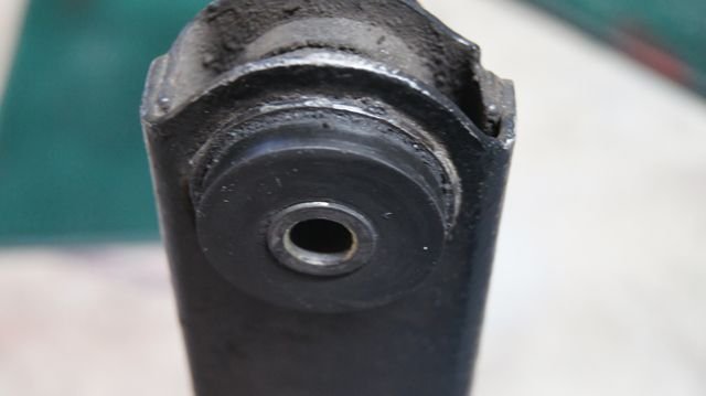

Here is what I installed back in 2013, car is mainly used for track days. Brand is Prothane
Chevrolet Corvette 1978 | Prothane Suspension Parts
Here is the rear trailing arms bushings after 8 years of track days / street driving. (changed rear to ridetech suspension 2 years ago) They have never failed / made noise etc, Easy to install. They are still in the car today everywhere else. Now 10 years.

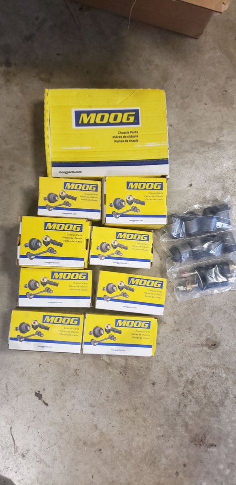

I bought all moog stuff from rock auto to rebuld my front suspension and rear spring bushings.. The front bushing I bought were the extreme energy poly ones though... I must have bought a different grade of moog problem solvers stuff because my purchase was only around $300 and that was with new moog front springs and eveything pictured above includng the swaybar hardware (ac delco on that) and drop pitman arm?
My moog stuff does say it was made in the usa as ive read they now source some of it overseas.
I bought all the tools to do it myself as the cars never seen a shop since ive owned it other than for inspections. POL sent me a tracking number for the tubular upper arms yesterday which were previously backordered. I have my lowers assembled and ready to go in once I have all the parts. I removed the balljoints that came with the arms and installed the moog stuff. the borgeson kit will be going in then also.. then shortly after, the new 3.55 rear end with the van steel crossmember delrin bushings and 2004r transmission.
