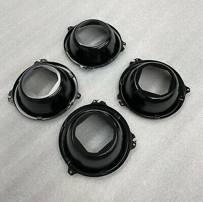

Originally Posted by nexus77241
So these are bone stock replacements? I don't need to drill the back of the cup and make it wider? Literally plug and play?? If so, I'm ordering them right now. HAHA
I have the 4000 lumen version of those same lights. The 2500 lumen lights fit as stock. The 4000 lumens have a slightly larger cooling fan and need about 1/8" clearance on the back of the cup to fit. I reamed out mine enough to clear, took about 5 minutes.

Hey! Nice outcome. I have a question. My mechanic said some brackets are missing but I just think he doesn't know how to install them. Any suggestion? Can you describe the installation process? Were there any brackets included in the bundle? Thank you from Italy!

Welcome to the forum! The headlights sit in a cup and are then contained by a polished trim ring.
I have these same headlights myself. They fit just like stock. They install just the same as any other headlight bulb, but with a short harness that fits behind the bulb.
