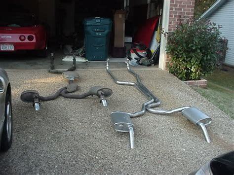

Does the 1980 have the goofball 1-sided exhaust? 2 into 1, into cat, then split back out to 2? I don't think it matters if you're going to get an aftermarket crossmember

Carriljc - yes my 1980 exhaust is as you described, like the picture Stringjc posted. So I don’t think I’ll havecavcrossmember issue with a system like that I’m considering. That’s why I like the CC Magnaflow system. I’ve read many users saying it goes on quite easily. Good job on your crossmember fab and thx for the picture and info
