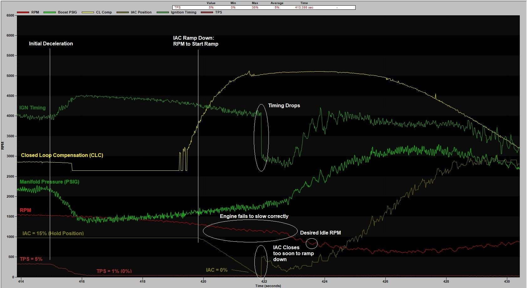

I added some more detail to the idle tuning notes in post #1. Included are two data logs that compare a not so smooth transition to idle vs a smoother transition to idle. Values aren't super important because every engine is slightly different. However, most engines fall into a RANGE of values that are common.
Not so smooth transition to idle:
Smoother transition to idle:
