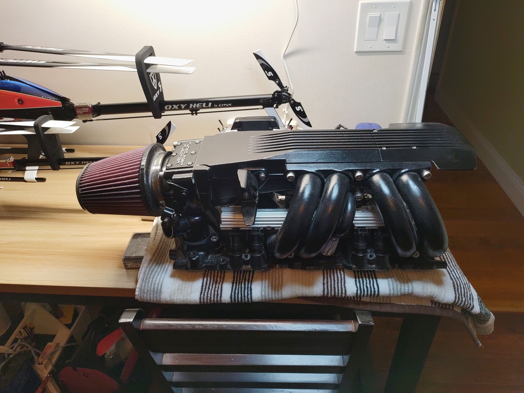

I really didn't want to publicly say what I'm planning but here it goes. Not to rag on the Crossfire, but TPI IMO is way better. So what I'm thinking is Flotek 180cc heads, a Comp Cam 12-388-4, TPI controled by a Megasquirt 2 for a nice mild 300HP. I have in my mind the visual appearance that's why I'm asking because the heads require roller rockers. I already have the TPI and the Megasquirt ready to go.

Well I just saw in "Related Thread" there are spaces available. I looked at Summit's site and they have them in various sizes. So I think I'll be okay.
