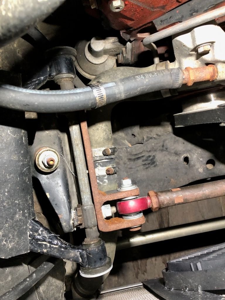

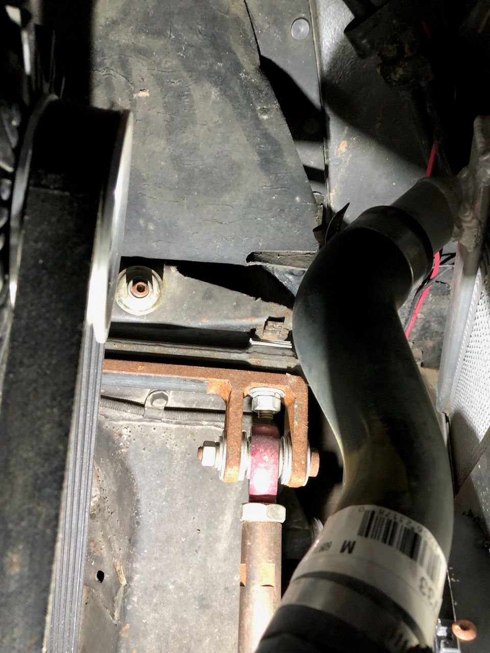

Don't know what I used but also made my own as a reference.
