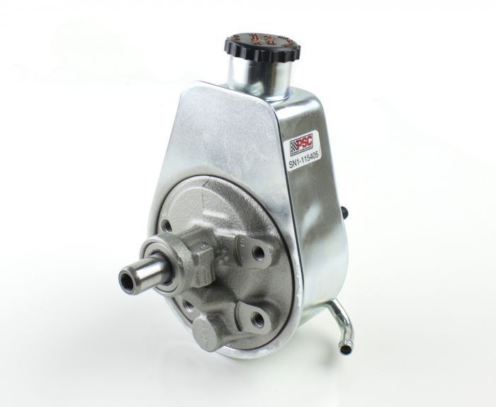

The reservoir can certainly leak. The pump is inserted into the tank with an o-ring. Other than that, you have the high and low pressure line connections.
This pic isn't applicable to a '71 but you can see how the pump mates with the tank.
That's a great picture to show where the sheet metal resevoir is connected to the cast iron pump assembly. The overhaul seal kit is cheap, fast and easy to install. Big o-ring for the side shown and a seal on the back where the mounting hardware goes thru the reservoir. You will need to borrow a tool from the auto parts store to remove the pulley but this is an easy do it yourself job.
