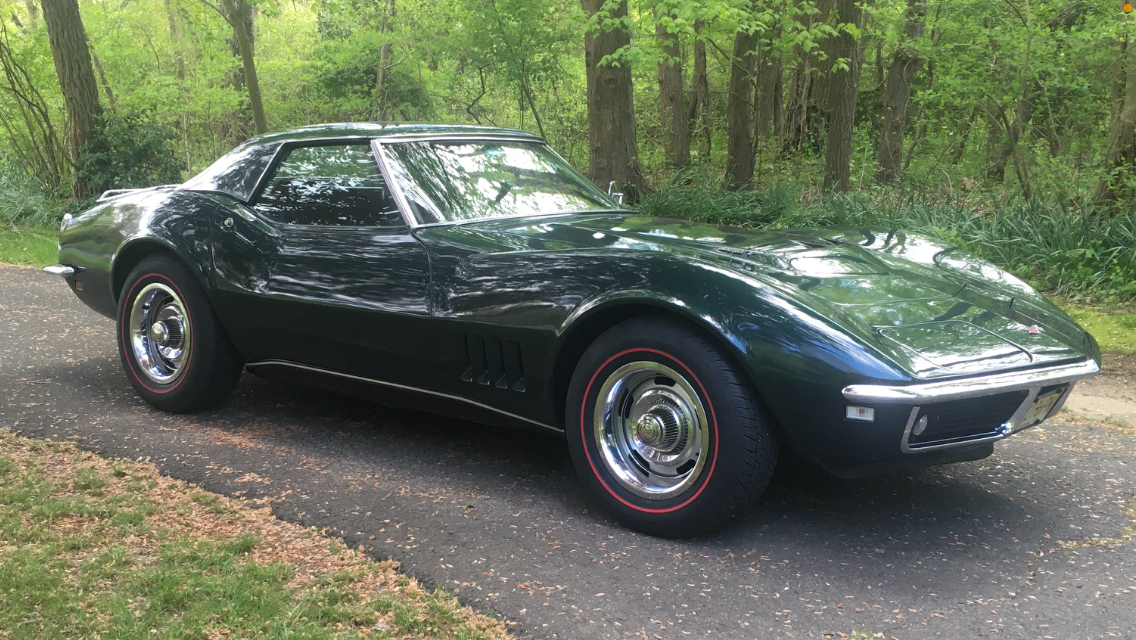

Just mounted these Coker Silvertown redlines and knowing what these cost you might believe me better when I say I wasn’t looking to spin these.
At least it still looks nice and I didn’t wreck it

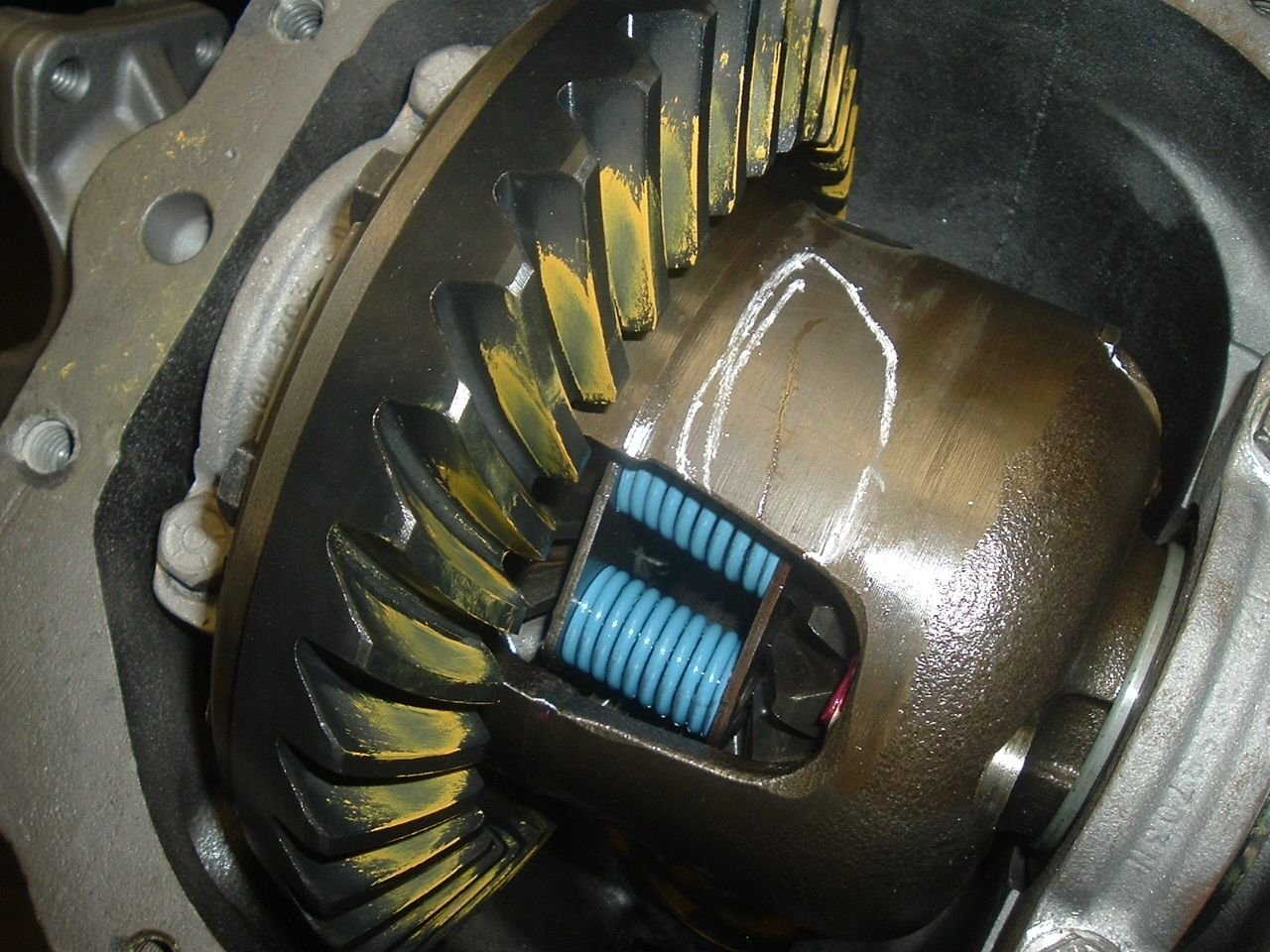

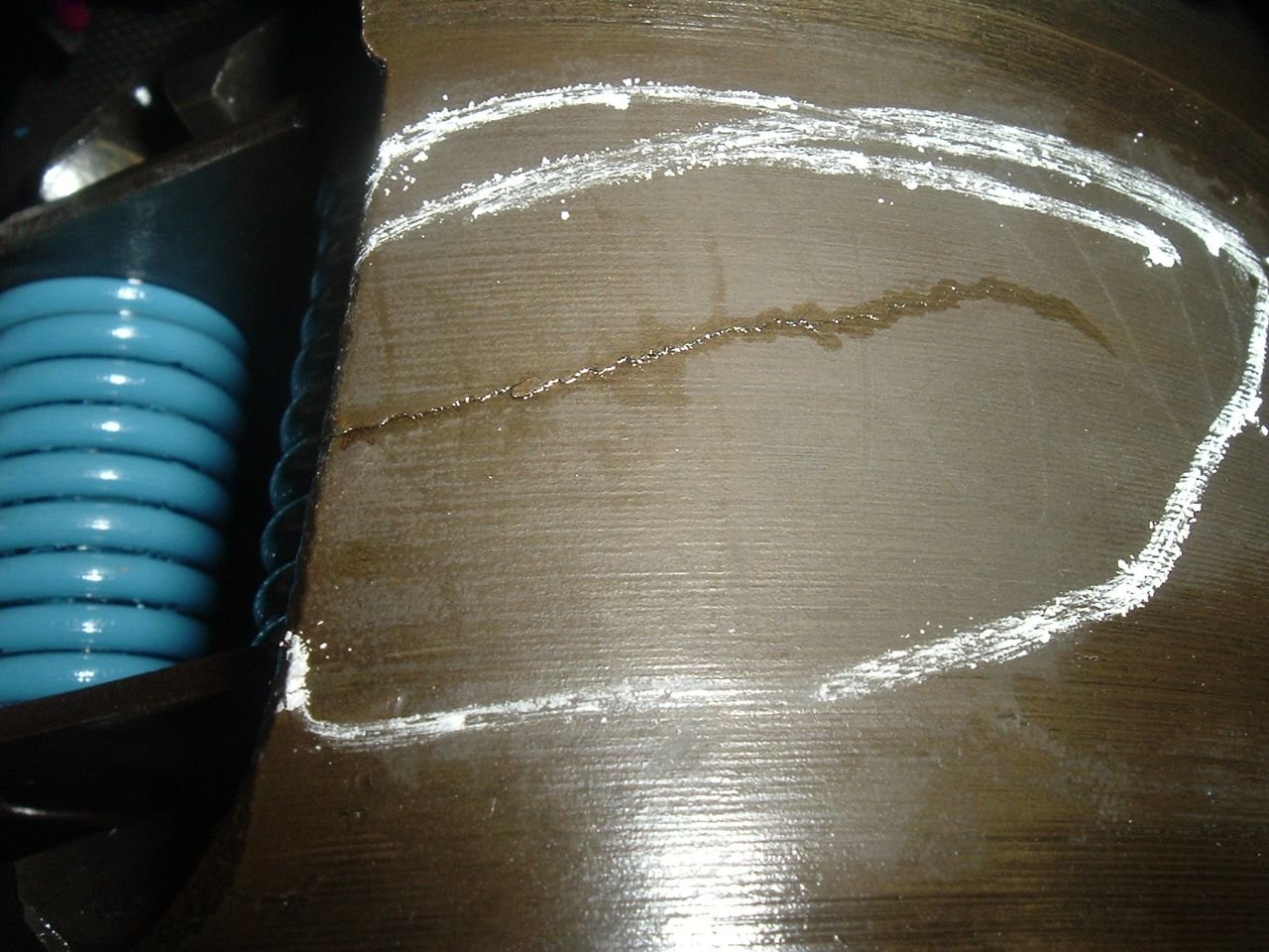

Just to add something to think about. I went back to my files and pulled this example of what I see a lot- from some well-known places. This goes back years, but things have not changed for the better.
This diff was an exchange, rebuilt diff from a very well-known vendor. The customer bought it and put it in his garage for a year. He had me blueprint his steering box and drove here to pick it up. When he did, he asked about the vendor he purchased the diff from and if I would inspect the diff before he installed it.
He had it with him so I put it on the stand, pulled the cover, looked down, and told him it was junk and would not last long. He was kind of surprised, since it took all of 30 seconds to pull the cover and tell him it was junk. So, I apologized to him and asked him to look at it, then I took some caulk and outlined the 2" crack in the posi case.
This posi case would have imploded, depending on how the car was driven maybe 1000 miles, maybe 5000, but it would have failed and his $1800 which was worth a lot more back then than today would be wasted. By the time that happened any recourse would be lost. This diff was NEVER installed, this is exactly how it was shipped to the customer.
He was very upset, to be polite. He called and argued with the owner and was told something to the effect of "It's a 40-year-old diff, what do you expect" He ended up getting his money back, but I can tell you time and again where I read guys had failures from this place and they continue to be in business.
So, when I hear people say they are going to bring it to a shop that does vettes, or races vettes, I ask them to ask the questions I listed above. It doesn't take long to see through fake people in this business. If they polish and tune a posi, ask for pictures- very simple thing to do. Then there are some who claim to do this and put in about 15 minutes on it, saying it would take off too much material. Yes, if you don't know what you're doing that can be true, but the real reason is time and money.
Now today with all the selling off of smaller businesses, do you really think things will be better? Many places that once rebuilt units now get them from wholesalers or conmen.
I can spend the next 8 hours writing similar stories, like the place everyone thinks is great but never sees their work. They take worn out steering boxes, flip the worm nut upside down, and resell them. You buy them, they are junk. The place you bought them from has no clue since they just bought them wholesale from the rebuilder and resell them. After spending and wasting time and money you move on to a Borgeson box -without really knowing what a correctly built box would be like. I see the same for Trailing Arms, look at how many are for sale on ebay. Some out there have been scamming well before there was a WWW.
Good luck.

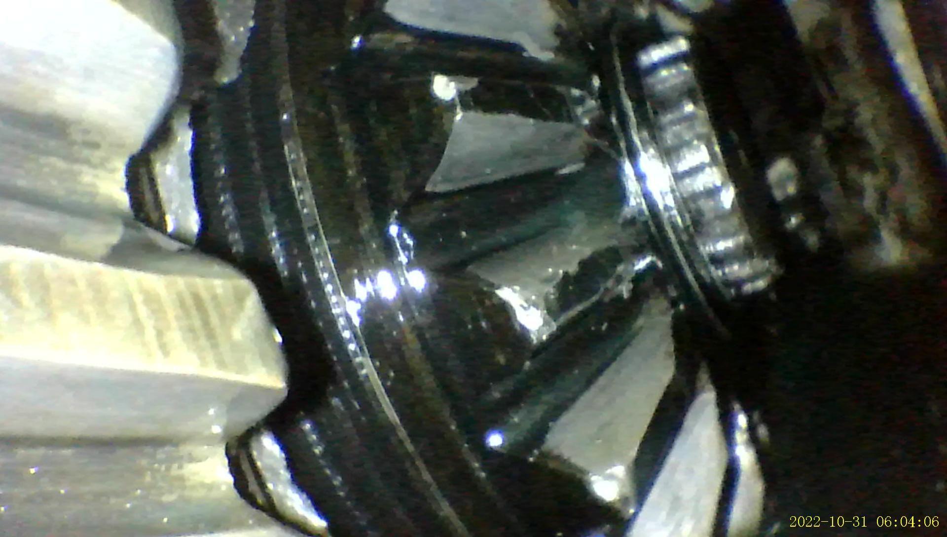

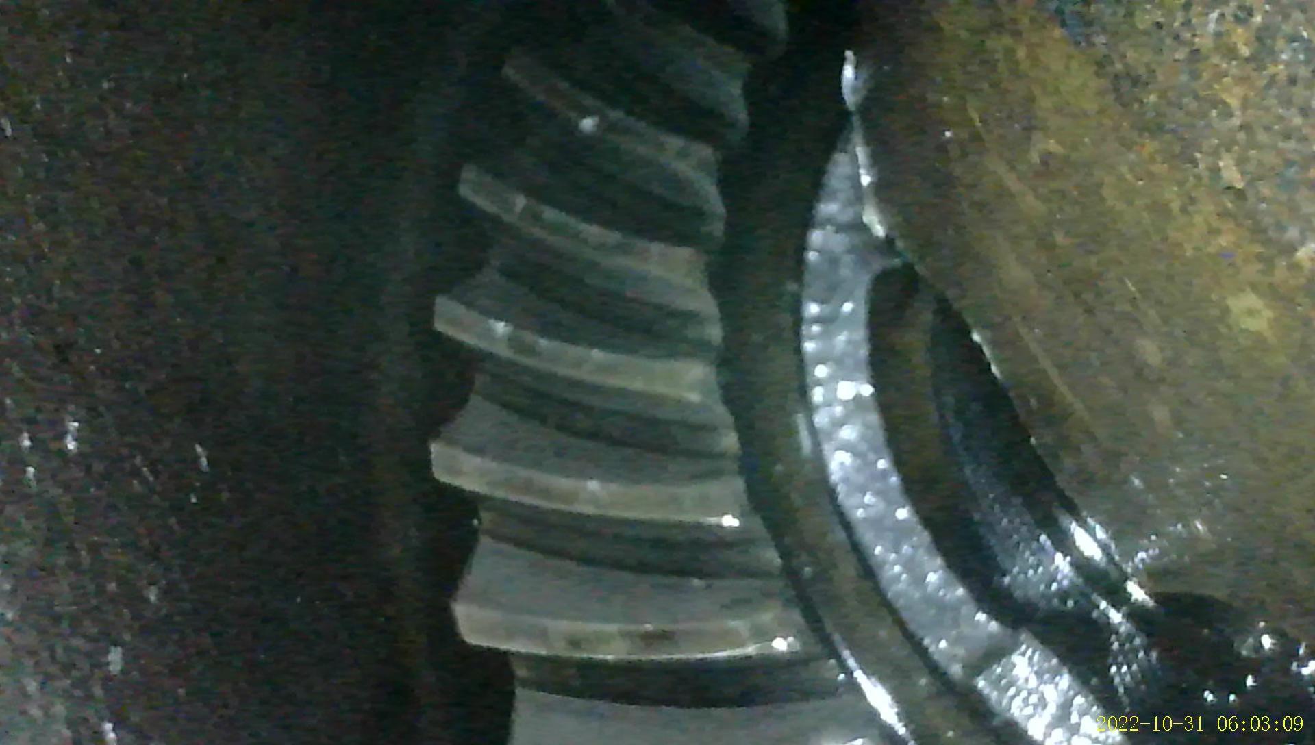

After service today I put the car up on jackstands and got to work pulling the spare tire carrier down so I could get to the fill plug on the diff. I also gave all the universals a good inspection and they all look fine. With the plug removed I used a bore scope inspection camera to have a look inside.
Well its official, the rear is blown !
the posi units center section is gone! The right and left axles have no connection turning independently. The ring gear looks ok but it hasn’t been removed yet for a pro to inspect so …. I’m leaning heavily on changing the gear ratio from the 3.08 to a 3.36 set anyway. I’ll have it out in the next couple days and will be moving forward towards getting it rebuilt. Looking into which posi to go with. A lot seem to use the Yukon units but not sure what their quality is. Eaton should be good if its available. I remember Moroso Brute Strength being good back in the day (?). Then I’m hearing about the newer gears made today like Richmond hum loudly…
Lots to consider.
I have to assume the springs and a lot of other parts that surround the spider gears are lying at the bottom under the oil.
