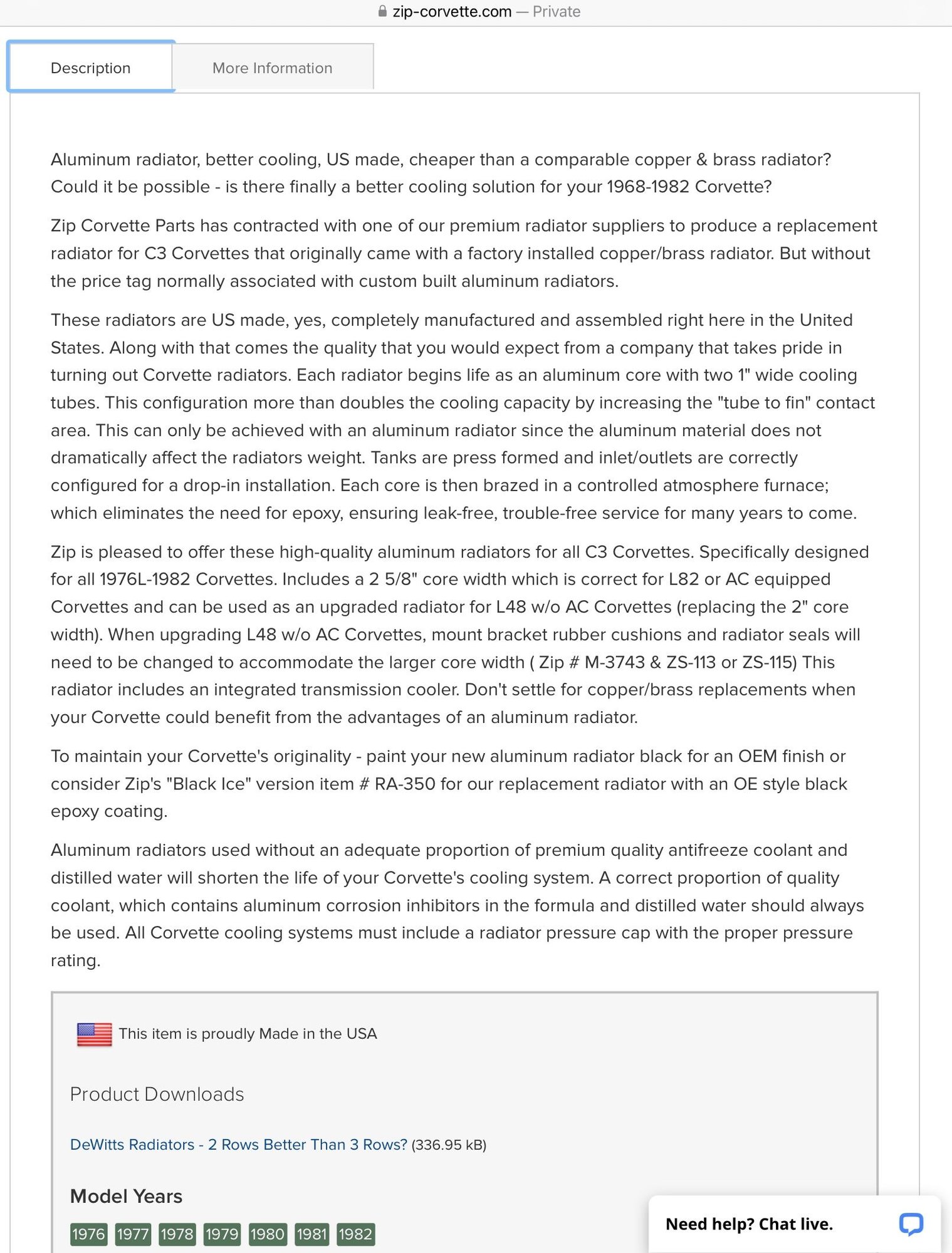

Not sure different widths, but i went usa made universal fit 2 5/8 frm zip for 1/3 of dewitts site..aluminum rocks for what is probably the hottest running years of c3’s with ac, retarded timing and 195f thermostat etc..
https://www.corvetteforum.com/forums...nt-79-l82.html
