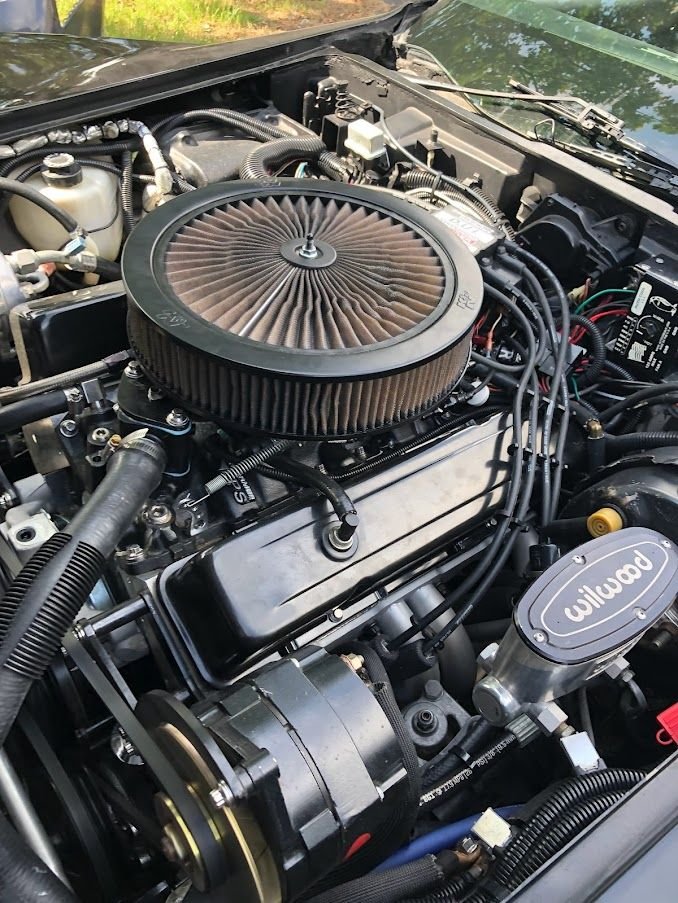

I just built a 385ci small block with a standard basecircle hydraulic roller cam using an Eagle rotating assembly with Mahle pistons....6.0" rod. I mocked up all 8 pistons on the rotating assembly and not one thing hit anywhere and the rods cleared by a mile......this was a circa 1990 roller block with a stock 1987 C4 Corvette pan (which is a great pan for these builds in a Vette....exactly like the old "long" sump Vette pan but for one piece seal...sadly, no one repops it....we found ours on E-Bay...for $75).....Eagle and Scat finally figured out how to build a strong rod that clears everything.....and it was 100% the rod the reason for stroke clearance......400 Chevrolets were not stroke clearance from the factory with stock rods ....sooooooooo.......
This engine used a 180 Dart Pro-1 head that I spec'd (and that I spent about 4 hours on the bowl area on-just a touch up) and a healthy Howards hyd. roller cam with a Performer EPS intake that I cut down the center divider a bit.......it is 10.4 to 1 compression with a 750 Street HP Holley vac sec....
The customer is a member of this forum.....it is in an 80' Vette . He claims he had to learn how to drive the car again because it spins the tire anywhere in the rev range from 2000-5000....and shifts out clean at 5600 rpm.....I estimate it makes 450hp and about 500ft/lbs. torque........
The customer/forum member let me experiment on him about my large carb/large cam/small head theory.......and it is a resounding success.......
There is really nothing in the 350ci arena that you should stay away from......some say the one piece blocks are weaker but I have never confirmed this to be true and GM builds crate circle track engines on them to this day. Late model Vortec style blocks have no mechanical fuel pump provision......and no bypass for the water pump so this needs to be plugged at the pump bypass hole......
Always build as much compression as possible into the build.....small blocks will go 10.5 to 1 on pump gas no problem with fast burn chamber (which most modern aftermarket heads have).......you can run a larger cam with high compression, they are easy to tune and sound terrific......
Low lift flow and high velocity is the name of the game on the street......small ports with high CFM rating will make Kansas flat torque curves and plenty of horsepower......there is really no need to build an engine that revs over 5800rpm unless you want it or you are class racing.......
I always try to encourage folks to make the jump to a 406 if they can....but this isn't always in the cards as some have blocks already that they want to use....400 blocks are drying up.....but if you have the money for a Dart block, do it.....the 406 will make a believer out of you and is my favorite SBC combo......IMHO, you will never need more on the street than a 406 can provide.....and the no stroke clearance deal works here too......
Lastly, the biggest thing to look out for are not the parts....but the guy who specs them......you can lose a LOT of value by having some pretentious bonehead spec parts for your build (there are a LOT of these people out there still).......then you are stuck making **** work that spent a small fortune on for substandard results.
Jebby
THANKS JEBBY
FOR AN INCREDIBLE BUILD!
I"M LOVING IT!
