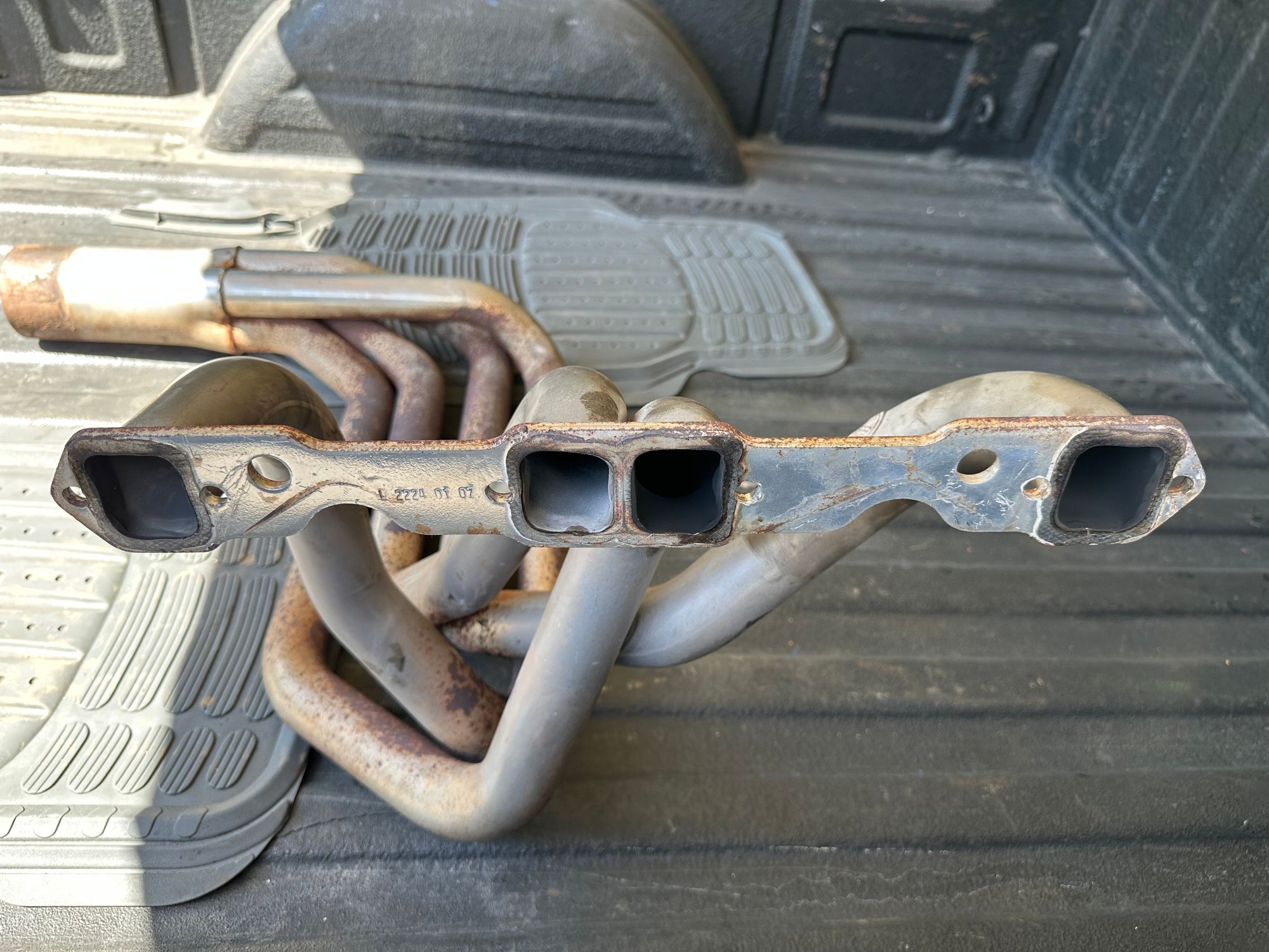

Ok. This engine won't run right unless it has a ton of advance. Right now if the throttle is cracked fast it will either cough through the carb or back fire through it. The more advanced the timing gets the less it does it. It's advanced far enough now that the vacuum canister is about to hit the intake. Would a lean engine need a bunch of advance? Is that what Im possibly fighting here? Here is a picture of the headers I've recently taken off of the car. Way lean at the back of the motor on both sides.
