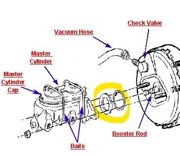

When I removed my original master cylinder on my 78, there was a rubber seal and some sort of metal retainer between the master cylinder and the booster. The seal, which I assumed was assembled at the factory, appears to have fallen out of the groove during assembly and was pinched and permanently deformed. I searched this forum and have not yet found any reasonable explanation of what this is for! In addition, I have yet to find a stock replacement on the corvette parts sites. I did read somewhere that others have replaced with an O-ring. If you know what the function is, please share, otherwise considering trying an O-ring or leaving it out since I can find an exact replacement.

There was no seal on mine when I replaced the master, and I haven’t come across any consequences of not having it.
In your case, if you don’t have an adjustable booster rod to compensate, not having that thickness may affect the booster rod interface to the master slightly. If your brakes are dragging (slightly engaged) when at rest after your install, this could be why.

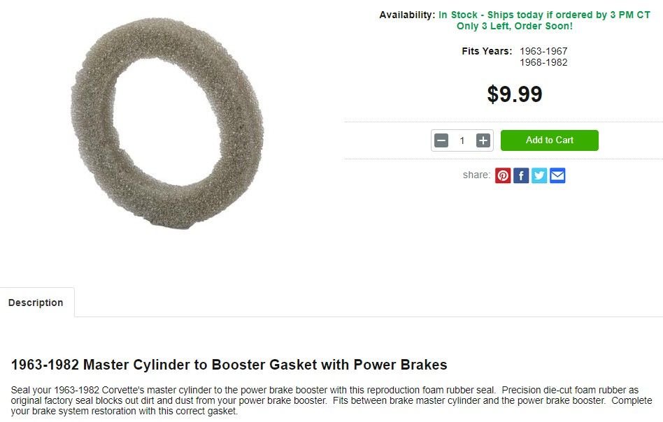

I've read some old posts that many older C3's don't have. Mine wasn't even installed correctly at the factory so it likely wasn't sealing anything! My best guess it is only there to keep moister and or debris away from the booster rod...but only a guess. I see this flimsy looking thing that has the correct description.

Its basically a "dust" seal. You can install a new one or maybe make one.
What a rip-off. $10 + tax, shpg for 3 cents worth of material.

This
https://www.zip-corvette.com/63-82-r...foam-seal.html
