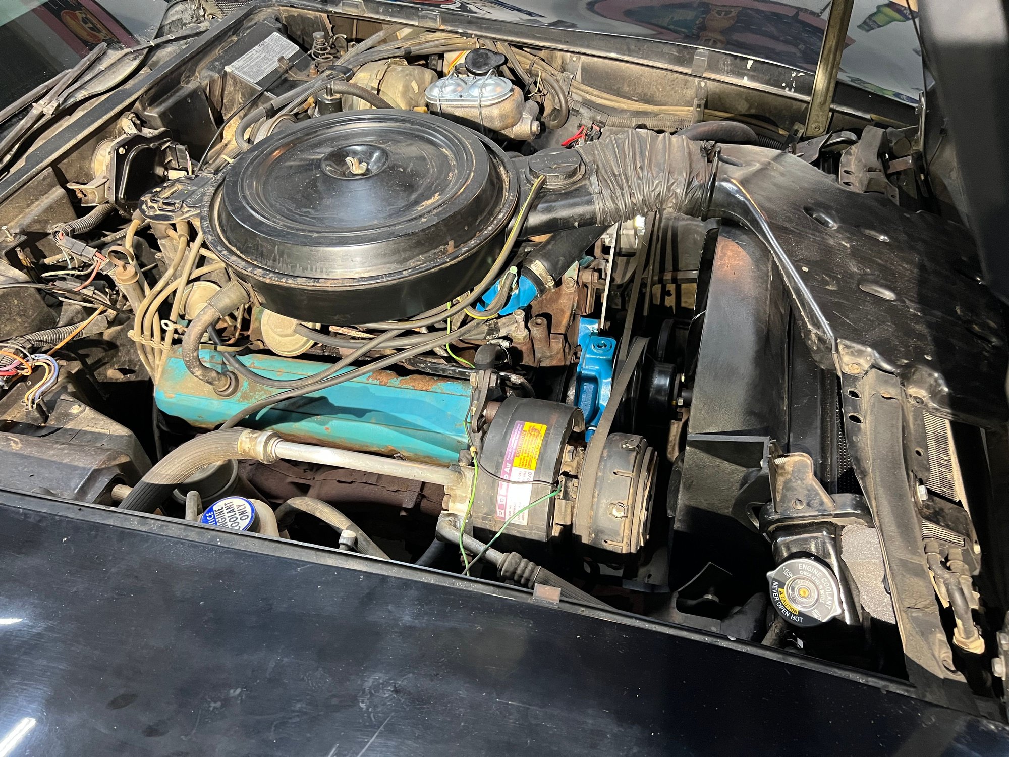

What else should be updated before I start driving any distances? 1978 L48 auto w/20K miles, been in storage for past 20-30 years. I’ve now replaced the entire exhaust, brakes, cooling systems and alternator. Repacked front wheel bearings, changed all belts, many hoses, plugs & oil. Car seems to run and drive fine but only been in the neighborhood so far. The front
control arm bushings look bad; have ordered new. Also getting tires replaced next week.
After checking, this is what I found doesn’t work so far:
  1. Steering seems to work fine but leaking fluid around valve, cylinder and related hoses. What to replace?
  2. A/C: plan to take it to a local shop for inspection and recommendation.
  3. Windshield washer – plan to remove check and replace pump as needed.
  4. Power antenna
  5. clock
  6. Questions:
  7. Ball joints – cannot imagine not changing while I’m doing the bushings, thoughts?
  8. Sway bar links – same as above, but no visible degradation.
  9. Tie rod ends
  10. Shocks?
  11. Rear control arm bushings?
  12. Fuel pump?
  13. Carburetor rebuild? Seems it idle too high at cold start. Also takes a while at first start of the day.

If the vehicle only has 20K showing, I would not bother with suspension parts until 40 - 50K miles.
Fuel pump should be fine. But the PS will need several parts before this story is over.
Two things that I would do, not because of the mileage, but because it has been sitting, maybe collecting condensation:
Purchase a fluid transfer hand pump. Remove everything you can out of the rear diff and refill. Both of the GM fluids are available on Amazon at a reasonable price.
Then, I see you have a hoist, so I would order a trans pan gasket, new filter and the required amount of ATF. Drop the pan, and renew that portion of the drivetrain.

Thanks for all the feedback! Below is my new list. BTW I took the car out on the open road today and have a bad vibration...seems to be coming from the rear. I have new tires on order and have an appointment next Wednesday to replace, so I hope that's it.
1) Change the front control arm bushings but not the ball joints or tie rod ends, yet. still need to find a spring compressor...any suggestions.
2) Change differential lube
3) Trans filter and fluid
4) Change rubber fuel lines at tank. I changed the front hoses near the pump already. I need to get the spare out of the way. The key lock is frozen but haven't spent that much time yet trying to get it off.
5) Change the ignition control module. This may be the reason it cranks so long when cold, based on what I read. I assume I should also change the cap, rotor and plug wires. If anyone has recommendation for best quality brand/source, please share.
6) Rebuild the carb. My old boss (retired) said he'd do it and claims he wrote the manual when he worked for GM, Rochester NY in the late 70's. I assume I just need to buy the rebuild kit from Cliff's, but which one? Seems to be many.
7) My turn signal seems very difficult to move. Need to Figure out how to clean and lube it.
8) Clean and lube the clock, change the dash light bulbs.
9) Power window work, but agree should pull door panels and lube tracks.
10) I noticed my rubber bushing on the rear leaf spring look bad, so I'll order that kit and replace as well.
11) More research is needed on the steering system.

Its amazing how the to-do list grows with more and more "while I'm theres" and "might as wells", isn't it?
If you're going to do the control arm bushings, you might as well do the ball joints too. The arms will already be out of the car at that point. Include the swaybar links and tierods in that group too, since they're coming out or being disconnected anyway. Check your idler arm, if you haven't already. Trans service is not a bad idea. Diff fluid change is good too. The fluids may not be in that bad of shape, but you'll have piece of mind knowing exactly how old and how many miles they have on them once they're changed. Grease all of your zerks that you find (but not the one on the steering control valve!). For your steering, replace all the components as a set (valve, ram, lines) and source your replacements from LoneStar Caliper if you don't want to rebuild them yourself. The Corvette parts vendors, like VolVette, Zip, etc. usually get their rebuilt PS components from them. Avoid the parts store rebuilt crap!
Once you get the safety things tidied up and have driven it for a bit, then make a decision about the shocks. The ones on the car may still have life left. Or just check them when you pull the front suspension apart for the bushings, ball joints, etc.
The clock? Meh. If you're going to tear into the center console to get at the clock, I'd replace it with an '81-'82 Oil Temp gauge, but that's me. If you do decide to fix the clock, make sure you change all of your light bulbs while you're in there. Replacement incandescents are cheap and there's no better time to do it.
Carb rebuild? Send it to Lars.
Taking a while to kick over while cranking is probably more fuel-related than ignition. The carb bowl is probably emptying when sitting (being siphoned out and back down through the fuel pump) and it has to be refilled on a cold start, which would take longer for it to begin spitting fuel into the intake. Bottom plugs on Q-jets very rarely leak.
