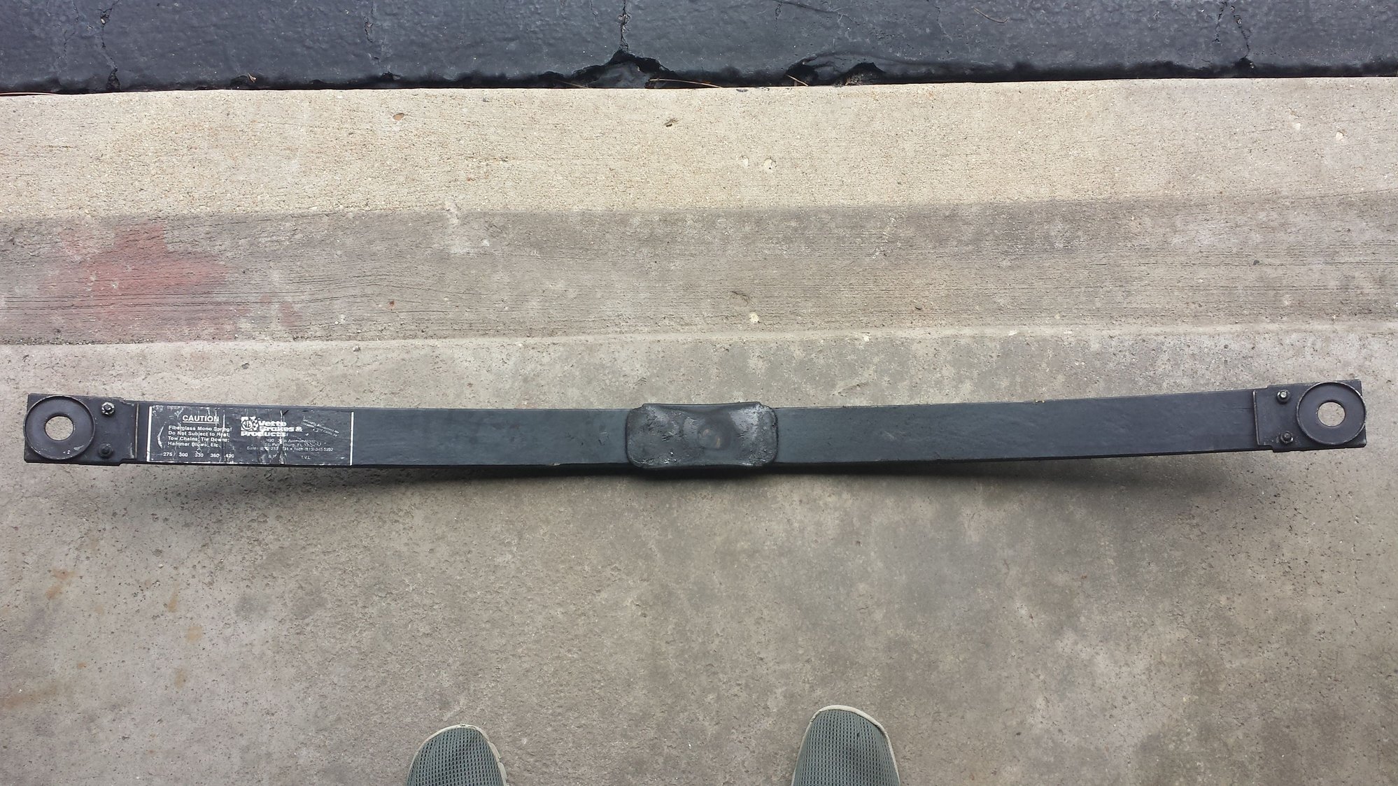

Here's a photo of my VBP spring label and I don't see a "PRM". Can you post a photo of the label you have?

I purchased my VB&P spring in the mid 90's. The sticker on mine is just as post number 2. With a hole punched out under the spring rating.
also, as stated above. No mention of the rating you described. Mine is absolutely identical to post number 2.
