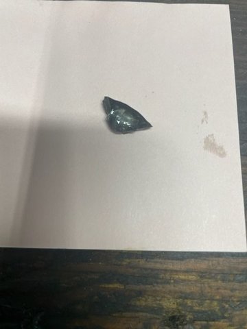

So I'm pretty sure I found the issue, check out the pics... I've never seen a stock SBC rocker arm do that... And I found the piece by the oil drain of #7.... It broke clean off. I have not taken it off yet to check the top of the valve but there is no metal laying in the head....
Are all stock rockers arms the same, ratio and what ever...

You are lucky that was a clean break. Yes, all the rockers are the same. When you replace it get the pivot ball also. Unusual failure , I've done that racing but never on the street. Good job tracking that down ! I bet there is no other damage, but check to see the keepers are in place.

Are those stem guided rockers? How much cam is in it? Springs? Stock rockers can handle a lot....maybe time to ck them all and or upgrade maybe? But as I said...lots of roundy round guys just use stockers and scream all night.

Thats what they look like. I've never been a big fan of them, thats the failure point.

There was a poster on here a few years back that broke the other end of the rocker. Pushrod sticking right though. Come to find out, that pushrod was plugged.
I think I would pull each pushrod ONE AT A TIME, blow compressed air through, re install in the exact same spot again.
If you have a valve-spring compressor, I would install it at the bad rocker stud and test the spring to make sure the valve is not restricted in its guide. Somethings not right there. I have never seen a rocker get abused like that.
As a last thought, consider a set of Comp Cams Roller Tip Rockers. They are 1.52 ratio, tough as nails and reasonably priced.

Yes, I'm gonna make sure the push rod is true and will make sure it's open, I'll run it with the valve cover off to verify it's spinning and will check the oil flow of the others. A buddy said he has some used rockers so I'm gonna slap on one of those and make sure the noise is gone, I'm hoping this was the only issue but you never know til the fat lady sings.... I'm wondering if it was the valve being pushed at a steep angle into the guide and the noise went away after the oil got fully up to the head and coated the stem...Take a look at the pic, the rocker was pushing on the very edge of the valve stem, maybe it was pushing it towards the outside of the engine instead of straight up and down and the guide was making noise. It really sounded like a water pump bearing and I can't understand why the tip of the valve would make that screech.... Hope I'm wrong and I didn't wreck the valve guide....
I looked at those rockers, PRW makes a set also....lets see about the valve first.. The top has just a small mark you can hardly feel with your finger nail, it's towards the inside edge and I think away from the normal wear surface. I'm going to buff that area with fine crocus cloth and run it.
