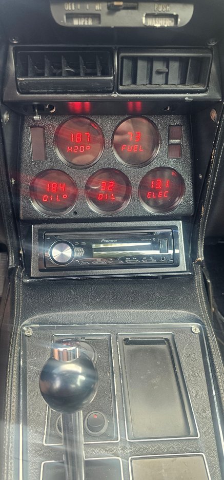

also my battery seems like it's drawing its only putting out about 12 8 volts at idle?!
please help!
11.8 without fans on!

11.8V without the fans on isn't good, should be 13.3V......It looks from one of your pictures that you have some sketchy wiring going on around your alternator....you might want to see about rewiring this properly for electric fans. Also get a volt meter and check voltage right at the alternator, as it could be different from what the gage reads.

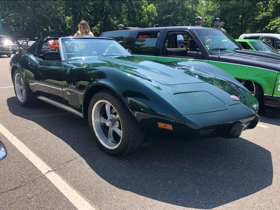

Thats quite a spoiler!
love the color.
