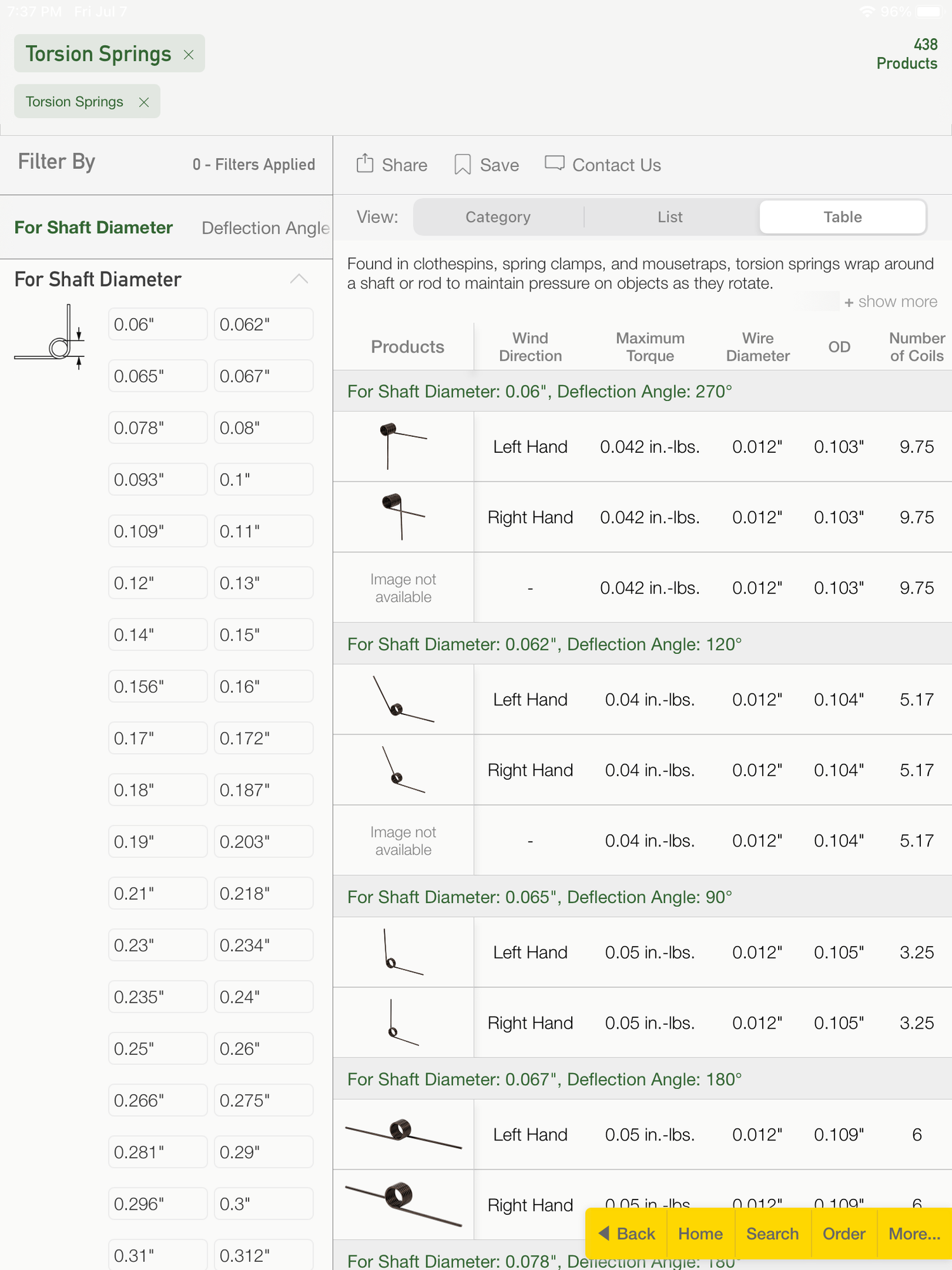

I’m fairly certain this broken spring(see photo) is the problem with my blend door not opening. I’ve replaced the vacuum actuator and vacuum is present at the hoses when A/C is selected. My question is where might I find one of these springs? I would imagine they’re used on other GM cars, but what do I know? It would be much appreciated if one of my fellow Corvette enthusiasts could post a photo of one that’s installed correctly. Now to the worst part of my post, I broke the damn thing myself.

Mcmaster carr?
