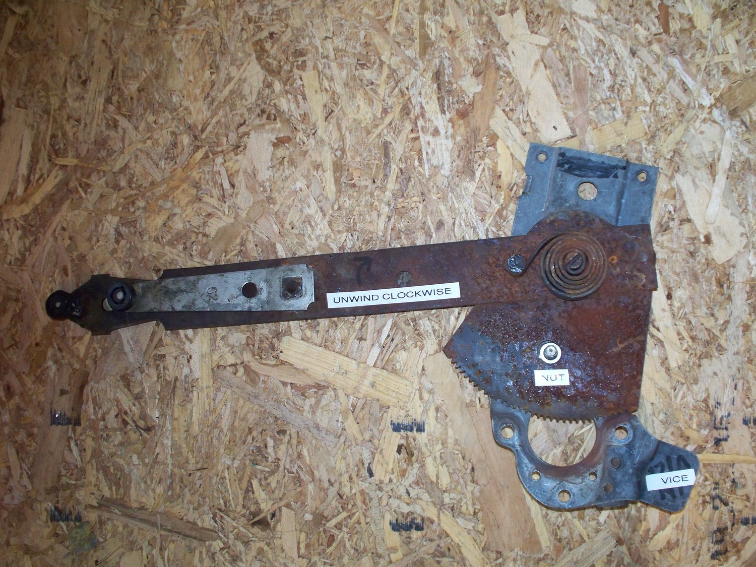

I recently got my doors built out and adjusted to the weatherstripping. I was patting myself on the back until I shut the door and the regulator spring on both doors fell off. I do have the spring situated correct but I guessing I need to “ clock” it back 180 to add more tension when the glass is in the down position? It seems like it’s a huge amount of tension? Hhhmmm.

Secure the regulator in a vice.
Have a helper hold the left side as you remove the bolt & nut.
Unwind clockwise.
Install the new spring and wind CCW and install the bolt & nut.
